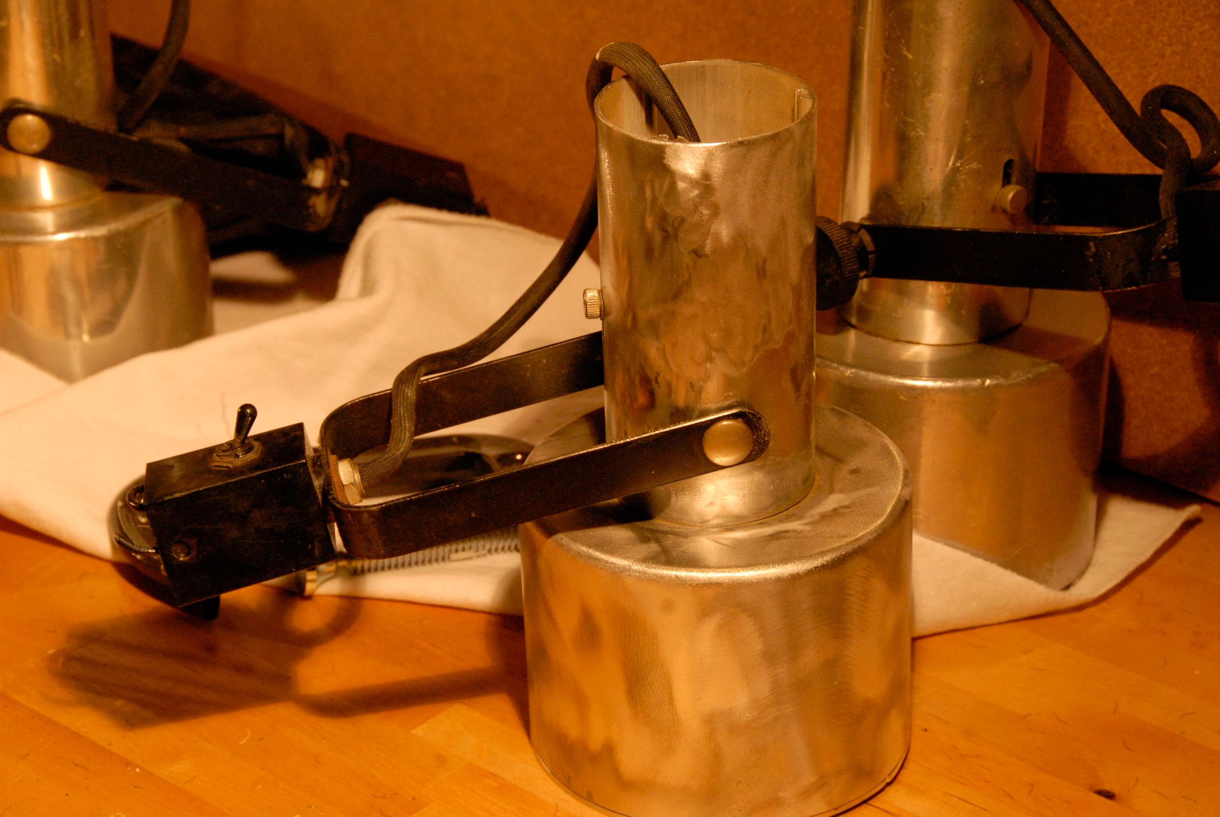

After assembling your photographic lamps, you need a tripod to mount them to. As these are not precision instruments, and this is a Low-Budget series, we don't want to go buy a nice manifrotto or something.
If your first stop is a thrift store, (and it probably should be) you might notice most of the available tripods are missing their quick release plate. These plates might cost three times as much as your bargain tripod for a new one. More than likely you won't even be able to find one.
Fortunately, most of these pieces are very simple. Chances are you have all the tools you need lying around.

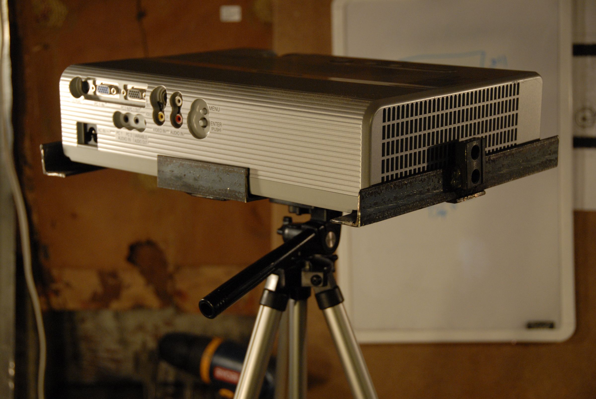

Step 2: Measure the Tripod
There are two steps to measuring the tripod. Because these plates have angles other than 90 degrees, we have to find a way to measure them.
My favorite method is to push a stack of card against the angled surface and then copy the slope for measuring with a protractor.
It's also good to keep a reference diagram handy. I scrawl one on a mini whiteboard so it's easy to edit.

Step 4: Cut the Wood
This is the first step that can include power tools. I used a table saw with an adjustable blade angle.
DO NOT USE A TABLE SAW! Table saws are statistically the most dangerous tools in your shop. I don't want to hear about anybody who loses the ability to touch type. A much better tool for this task is your standard pullsaw and miter box combo.
Now that the disclaimer is out of the way, cut along the marks you made for yourself. The angle isn't critical, but the closer you can get the better.

Step 6: Drill the Hole
Now you want to find the center of your plate and put a 1/4" hole through it. If you're using a screw, you also want to chamfer the bottom so the head of the screw is flush.
Step 7: The Bolt
Now for the addition of the bolt. A standard tripod mounting bolt is 1/4" with 20 threads per inch. You need one of these that is at least 1/4" longer than the thickness of your mounting plate. I used what I had lying around. You might want to get the proper size.
Once you've inserted the bolt, you want to clip a captive ring onto the other side of it so it stays put. I didn't have one, so I used a welder. Remember that excuse should not apply to auto maintenance
Step 8: Success
You should now have a functional, if not fashionable, replacement mounting plate for your cheap tripod. If it looks like mine, it's also a contender for There I Fixed It.
