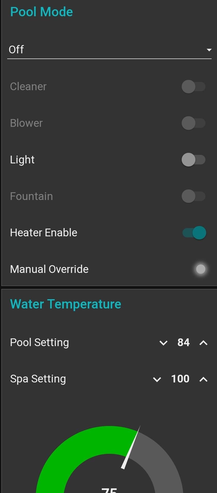

A web interface has user controls to choose between everything off, pool or spa mode. It has switches to turn on the pool cleaner, lights, air blower for the spa, and to enable the heater. It has temperature gauges for the water and it allows you to set the temperature of the pool and spa so that when they are on, the heater will bring the water up to temperature and then turn off. It has a second temperature gauge for the outside air temperature.
The web interface is written in Node Red and runs on a Raspberry Pi which is inside my house. There is an Arduino Nano which is outside the house near the pool equipment. The Raspberry Pi monitors all the user controls and temperature settings and periodically communicates with the Arduino over a USB cable to tell it what to do with each of the various devices that the controller controls. The Arduino also measures the water and air temperature and sends that information back to the Raspberry Pi.

The pool controller logic is implemented in Node Red on a Raspberry Pi. Node Red is a system that allows you to create logic flows graphically. The graphical representation makes it easy to understand the flow. You have to do a bit of programming in the nodes but that is not hard.
The UI is implemented with a set of Node Red nodes called the Node Red Dashboard. These nodes provide the dropdown that lets you choose pool, spa or off, the switches to turn on the cleaner, blower, lights and heater, the gauges to show water and air temperature, and the numeric input that lets you set the pool and spa temperatures. It automatically formats the various controls so it looks nice and works properly on a desktop computer web browser or on a smartphone browser.
The model for this flow is that inputs that come in via the serial port from the Arduino and from the various Node Red Dashboard controls set the state of the system. Periodically, a separate process reads the current state of the system, figures out what needs to be set on the Arduino and sends the appropriate commands as a serial message to the Arduino.
For example, there is a switch in the UI called Cleaner. When that switch is turned on, it sets a variable called CleanerSetting to true. There is a node called PoolControlHearbeat that reads the value of CleanerSetting. If it is true, it sends a message to the Arduino to turn on the relay for the cleaner.

Node Red Flow Description
If all is working, then you don't need to read this section, but if you are interested, this explains how the various parts of the Node Red flow work.
The ArduinoSerialGet node listens on the serial port for messages from the Arduino. Those messages have a keyword, one of H2O or AIR, followed by a colon and a number that is the value. The SerialMsgRouter node routes the message to one of two nodes corresponding to the keyword. The string is converted to a value that is sent to a gauge on the UI and a node that sets the value of a variable, H2OTemp or AIRTemp.
There are two nodes that set the default temperature settings for the pool, DefaultPoolTemperature (set in the node to 82) and DefaultSpaTemperature (set in the node to 100). Those values feed into the numeric controls on the UI so they have an initial value and also into the PoolTempSetter and the SpaTempSetter which set variables with the values. These are like thermostat settings, they are the temperature you want the pool water to be, while the H2OTemp is the temperature that the pool water is. The RelaySetter (described below) uses these to decide when to turn on the heater.
The Light switch turns the lights in the pool and spa on or off. The can be turned on whether the pool or spa is running or not.
The HeaterEnable switch does not directly turn on the heater. If it is off, then heater will not turn on in any situation. If it is on, then the heater will turn on if needed (see below). This allows you to maintain your temperature settings but not heat the pool until you decide to enable the heater.
The Cleaner switch turns on the automatic cleaner which is driven by a water line from the pump. That is controlled by a valve actuator.
The Blower switch turns on the air blower which adds bubbles to the spa. The blower is an electric motor.
The dropdown Off/Pool/Spa can be set to one of three values: Off, Pool or Spa. This sets a variable, PoolSpaMode to one of those values. This mode is also part of what is used in the RelaySetter to determine when to turn on the heater. The mode also enables or disables certain controls. If the pool is on, then you do not want the air blower for the spa to be turned on. Conversely, if the spa is on, then you do not want the cleaner to be turned on. So, whenever the pool is turned on, it turns off the blower switch and disables it, and also enables the cleaner switch. Whenever the spa is turned on, it turns off the cleaner and disables it, and also enables the air blower. Whenever the Off setting is chosen, it turns off both the cleaner and blower.
The PoolControlHeartbeat periodically sends a message to the RelaySetter which triggers it to check the settings of the cleaner, blower, lights and send the corresponding relay settings to the Arduino. The RelaySetter turns on the pump relay if the mode is Pool or Spa and turns it off if the mode is Off. The RelaySetter also turns on the heater if necessary. It does this by first checking to see if the HeaterSetting is on, i.e., if the heater is enabled. If the heater is enabled, then it determines what is the appropriate temperature setting - if the mode is Pool, then it uses the PoolTempSetting value; if the mode is Spa, then it uses the SpaTempSetting value. It compares that value to the H2OTemp value, i.e., the current water temperature. If the current water temperature is below the setting, then it turns on the relay for the heater, otherwise it turns it off. Lastly, the RelaySetter sets the intake and return valve actuator relays to off if the mode is Pool and on if the mode is Spa.
Once all relay values are known, a single byte is created where each bit corresponds to a relay and where the bit is set (value 1) to turn on the relay and the bit is unset (value 0) to turn off the relay. This byte is sent as a serial message to the Arduino by the ArduinoSerialSet node.

Once you've set the times and imported the flow, the dropdown that formerly provided the options Off/Pool/Spa will have the options Off/Pool/Spa/Schedule. Select Schedule to run the schedule you set or choose Pool or Spa to override the schedule and run the pool or spa as you wish.
The freeze mode runs the pool and spa alternately for 15 minutes at a time. It accomplishes this by simply checking the current time and calculating which quarter of the hour it is in. The code runs one for the first 15 minutes of the hour, the other for the next 15 minutes, etc.
Usually, just ensuring the water is flowing will keep it from freezing. If it is cold enough, however, the water could still freeze (this happened once in 14 winters at my home, during the winter prior to this project). To prevent that, you can enable the heater on the Dashboard and set the pool and spa temperatures to some value just above freezing, e.g., 34 degrees so that it will turn on before the water actually freezes. This will work in Schedule mode. Of course, it will only work if you have not winterized the heater and thus disabled it!

Here's a pic of my dashboard. Thanks!
Reply 9 months ago
I can't think of any way for those relays to be reset other than in that function. Did you add any on/off settings that use the variable "buf"? If so, then that is the likely place to look for the issue. A suggestion to track it down is to start with the original, unmodified code, change just those two lines, see if it works as expected, then make one of your other changes at a time and test to see if any of them are the culprit. Another useful feature of Node Red is the debug node. You can send the output of RelaySettter to that as well as ArduinoSerialSet. That will help you isolate whether the relays are being turned off by NodeRed or by the Arduino.
Nice additions to the Dashboard!
