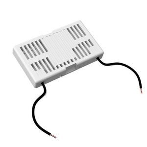

  • *If the total consumption of electrical appliances is below 20W, we also need Shelly Bypass.

The Shelly 1L's output will always be on, thus powering the other two Shelly 1PMs. If the total consumption of the appliances that Shelly 1L supplies is below 20W, it is necessary to add a Bypass.
