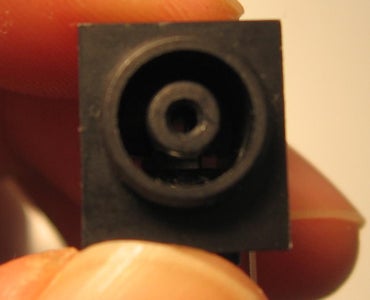

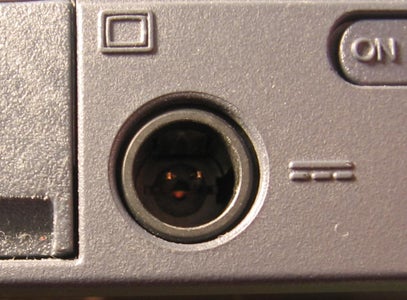

Step 1: Initial Diagnostics
You can observe the damaged DC jack on the back of my computer.
The new DC jack shows how it is supposed to be.

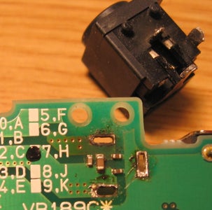

Step 9: Desoldering Old DC Power Jack
Finally you can see the circuit board for DC power.
Desolder your old DC jack following the This Guide "How To Desolder Components""How To Desolder Components"
Another and much better guide to desolder and re-solder a power jack is DC power jack repair guide. Do-it-yourself instructions. The credit goes to Laptop Freak.
I did not use desoldering pump. Instead, I bought desoldering braid from RadioShack for about $5. Soldering before desoldering works pretty well, though.
Step 10: Soldering New DC Power Jack
After desoldering, use the small flat driver to secure enough space to put new legs of DC jack.
Place the new jack, solder the legs.
