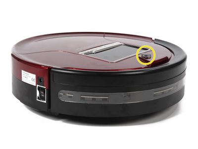

Step 4: Remove BObsweep Pethair's Screen
Remove the four screws holding the screen in place
Lift the screen up and it will detach from the cover.
The screen and cover buttons will lift out together, leaving an open space for your replacement parts to fit into.
If you remove the infrared sensor, replace it in its space on the new cover so the black side will be on bOb’s outside. (Highlighted Yellow)
Step 5: Place the New Screen
Lay the screen down over the screw posts in bObsweep's cover. Make sure it lies flat on top of the infrared sensor.
Then, install all four screws for the LCD display.
