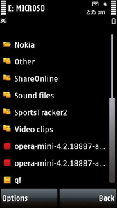

Step 1: Get Your Jad and Jar Files
Download the app you want to use, and make sure you have both the Jad and Jar files.

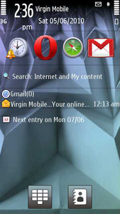

(note the second image: this is what Opera Mini 4 looks like with it's default icon)

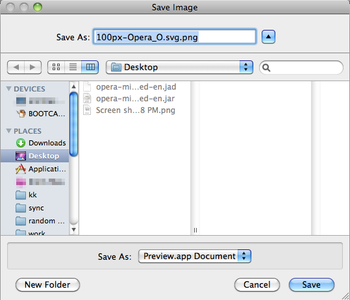

Step 2:
Right click and "save as" the icon you'd like to use for Gmail from the net.
It should be a PNG image with a transparent background, less than 100 x 100 px.
Google image search is what I used.
The one I downloaded was from Wikimedia commons. Please don't use other people's images unless they are under the appropriate Creative Commons licence.

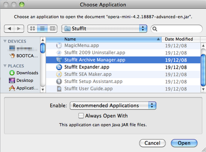

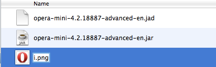

Step 4: Open the Jar File With Your Extraction Tool and Locate the Png Icon.
Open the JAR file with a good extraction tool, like Winrar or Stuffit.
Just open the file, don't extract it.
There is one png file in the JAR, this is the icon you want to replace.

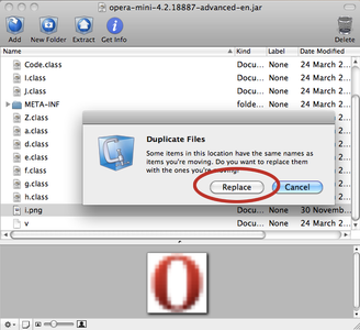

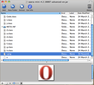

Step 5: Replace the Icon
Rename your PNG file to the exact same file name, and drag it in.
In my case, the file name was i.png.
Save the JAR file, and close your extraction tool.

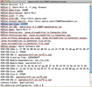

Step 6: Match the Jad and Jar File Sizes

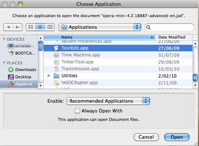

Open the JAD file in a text editor.
Locate the size of the JAR file in the JAD.
Right click on the JAR and write down it's exact size in BYTES.
Edit the JAD file so that the file size after the line "MIDlet-Jar-Size:" matches the JAR file you edited.
Save and close.
This eliminates the error "Jad and Jar size do not match"
Save and close.

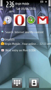

Step 8: Completion and Final Thoughts
Hooray! You now have an attractive icon for the App on your phone.
(please note: my phone's screenshot program compressed the image, the logo looks much nicer on my phone screen)

BUT in the JAD, you can find the URL to the JAR, pop it into your browser and download if to your computer, edit it to have a nice logo (as I have done in the image below) and transfer both files to your phone and install.
