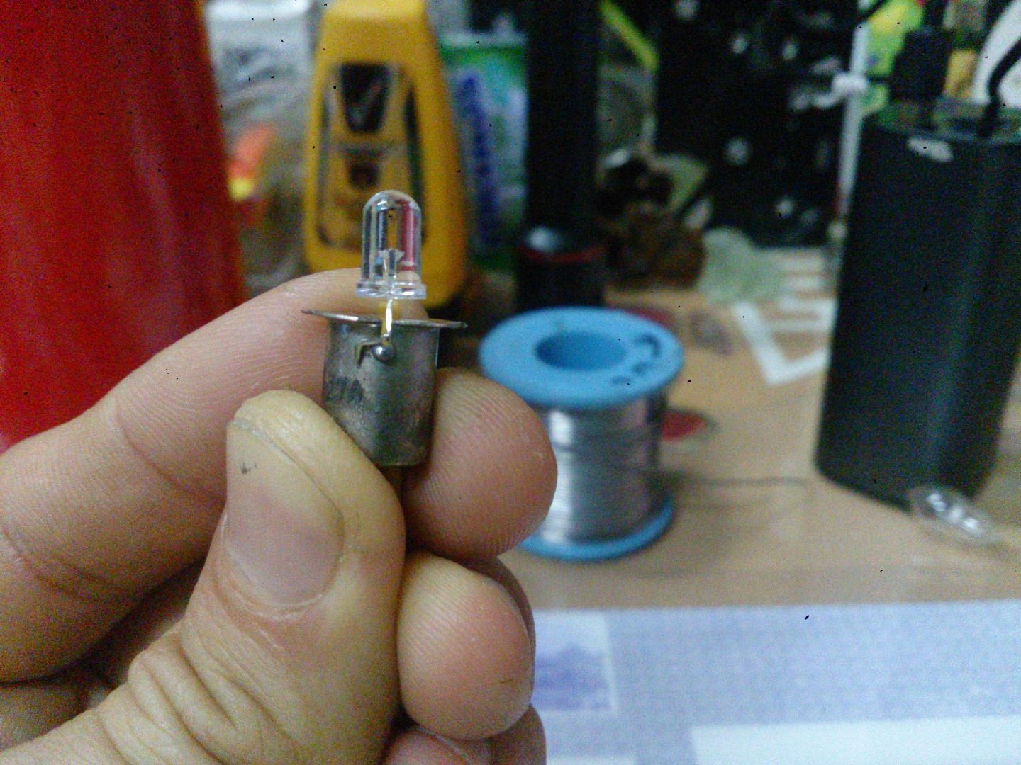

Take off the bulb from its base. It is small and fragile. You just need to move it left-right-left-right until it get loosen, then pull it out. Clean the whole base using a small screwdriver.

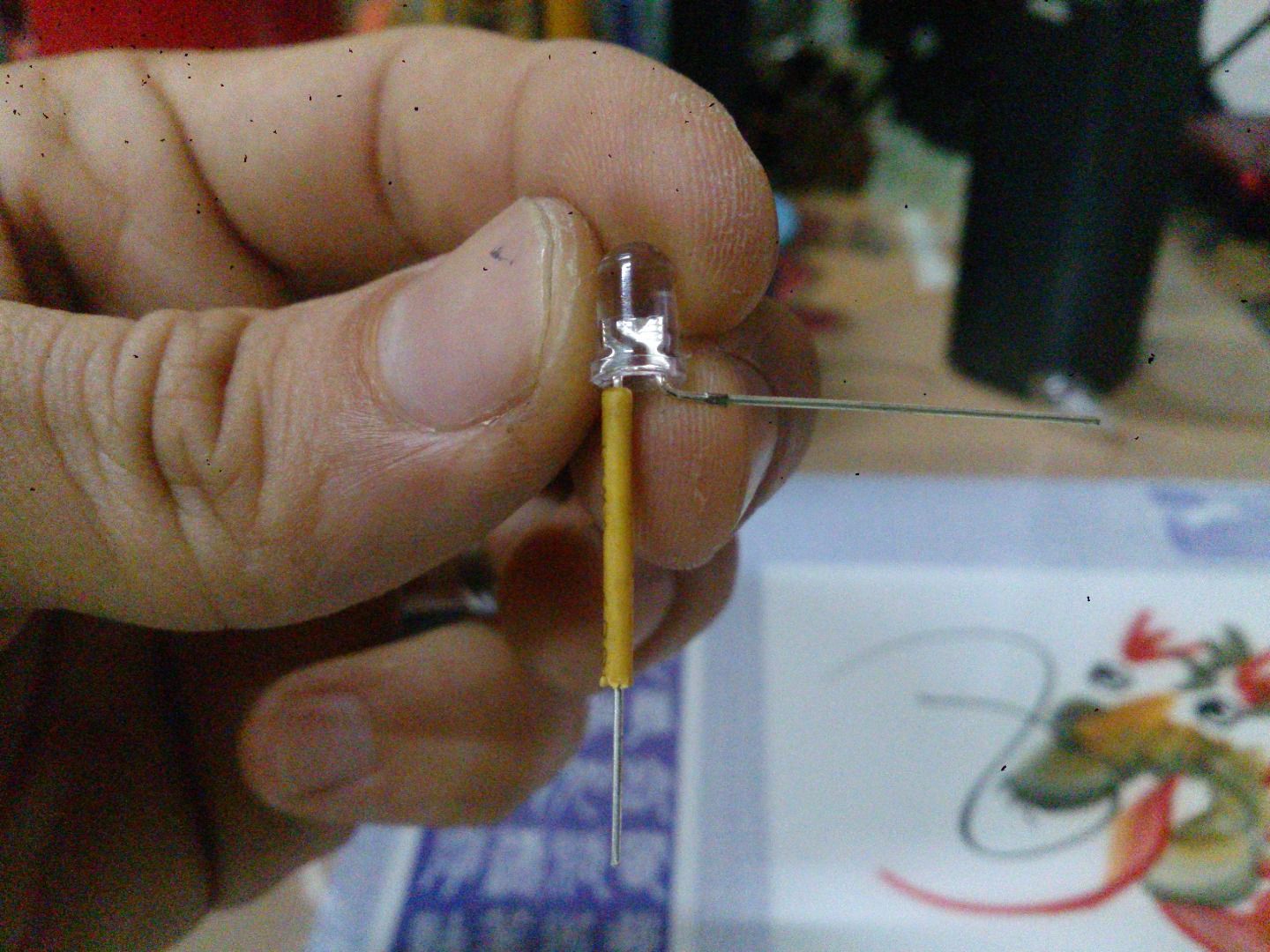

Bend the cathode (-) of your LED forming 90 degrees from the anode (+) of the LED. Well, for instant, the larger piece inside the LED is cathode and the smaller piece inside is anode. So far I keep remembering LED anode-cathode in this way, because I was once wrong when using longer-shorter pins due to factory's fault. For more confirm, please connect the led directly to 3 Volts battery, it won't light up if you put it the wrong way. Then bend the pin connected to the negative (-) of battery just like the photo above.
Get a small piece of wire, we need its jacket only, any wire whose jacket fit the LED pin. Pull out the wire strands, then put the LED anode (+) pin in it. This is to avoid shorting to the negative base.

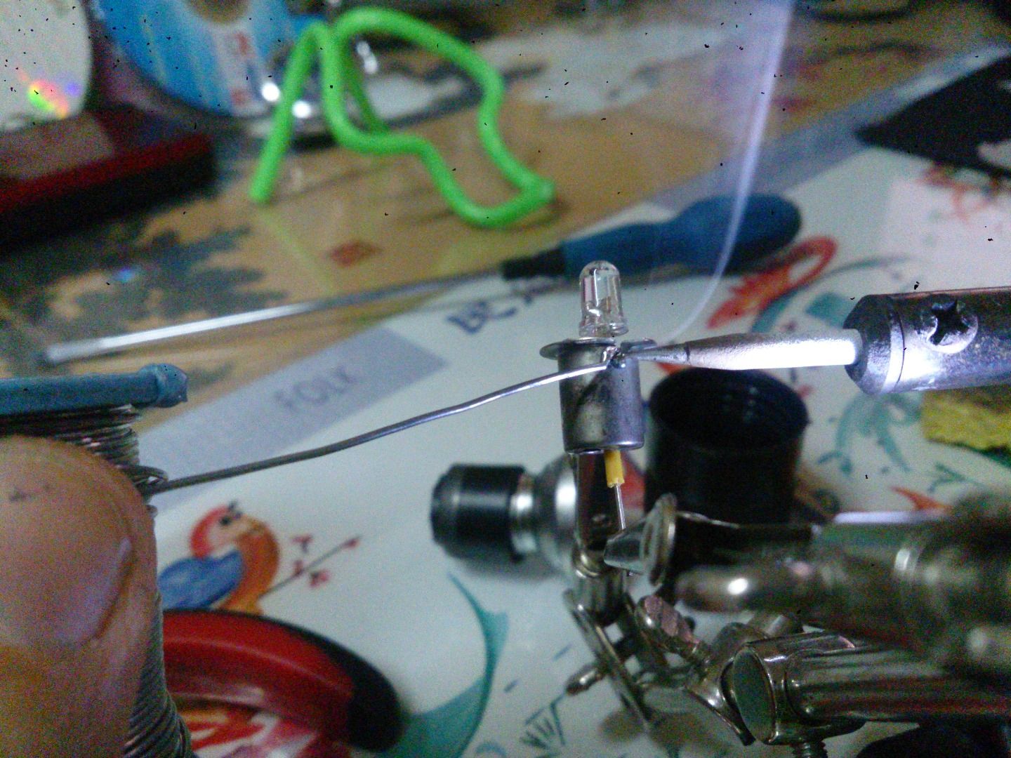

Now bend the cathode (-) pin down to the former bulb negative solder pad then smoke it... I mean solder it there :)

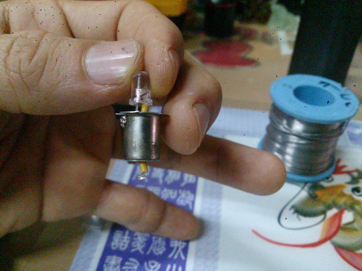

I use clear tape to seal the border of the anode (+) pin to avoid short. Actually I intended to fill it up with hot glue to make the LED steady on its new container but at that time I couldn't find one, while the deadline given by my son was expiring that day :D
So.. I lighted it up anyway.

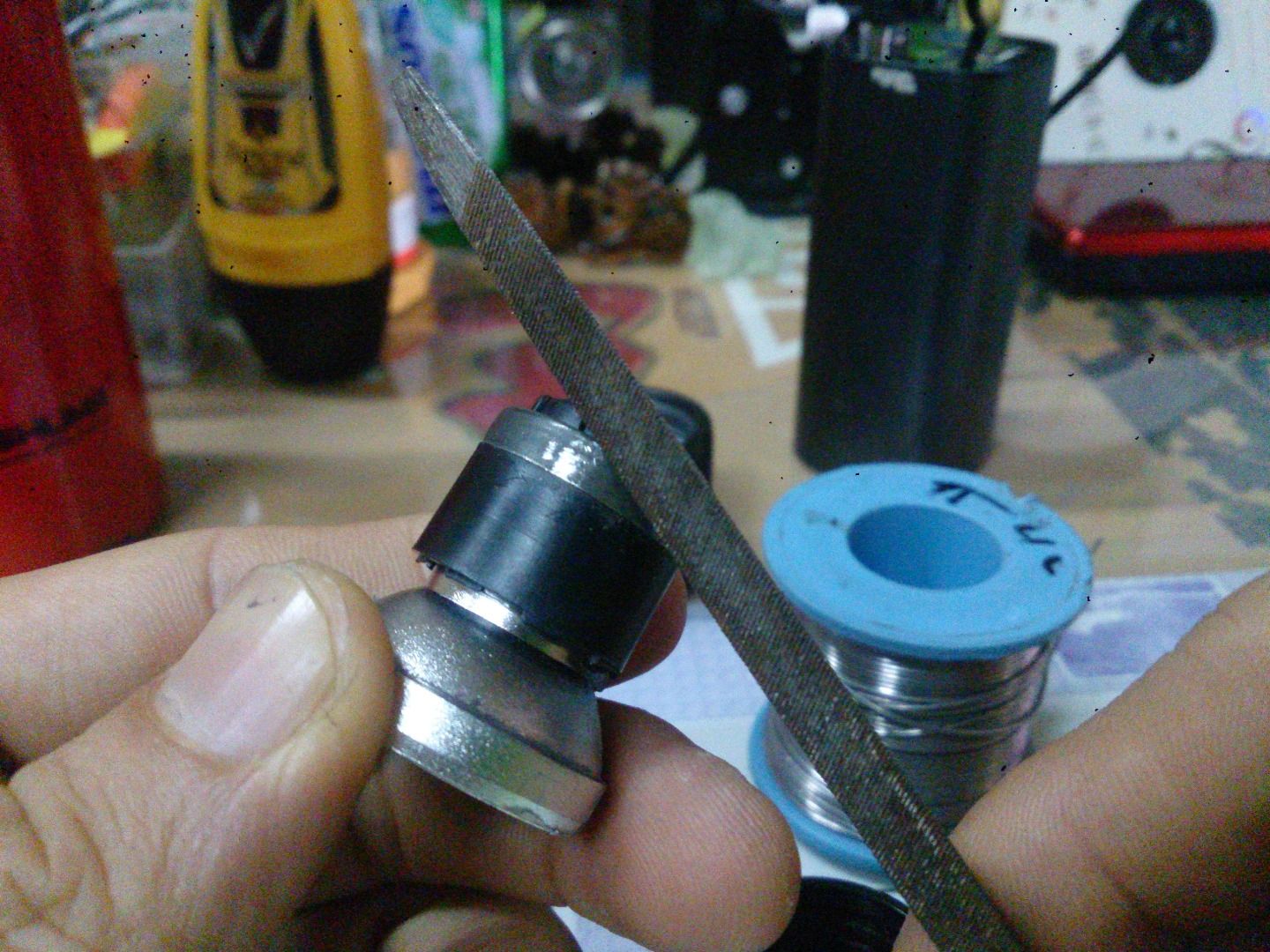

If you have a file handy, clean up the bulb negative contact which will be touched by the sliding switch connecting it to the negative of battery.
