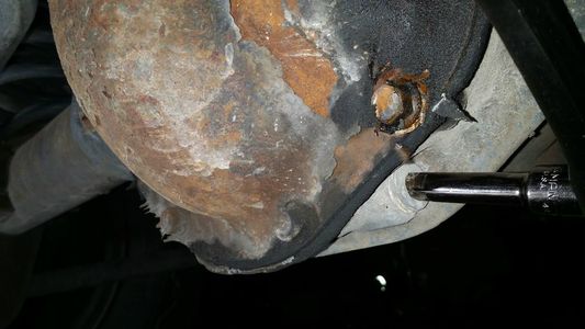

Step 2: Drain Differential and Remove Old Bolts
Begin by placing your oil drain pan under the drain bolt. Continue by using your 3/8" drive ratchet extension and inserting it into the lowest plug on the differential. Using the lefty loosey/righty tighty rules, loosen the plug and allow the gear oil to drain into the pan. Continue on and use your ratchet with the appropriately sized socket to remove as many of the bolts as possible around the perimeter of the differential cover. Use your combo box wrench to remove bolts that may be hard to reach with the ratchet. Once the bolts have all been removed pull on the cover and it will start to separate. you may need to use your razor blade or gasket scraper to get the process started. Be very careful if you choose to use the razor.

Step 5: Install New Cover
Using the Silicone Gasket Maker (RTV) trace the outline of your differential cover making sure to apply the sealant to the inside of the bolt holes in a continuous form. Line the new cover up on the differential housing and push into place. Make sure you have a bolt in hand as you'll want to anchor the cover once you've mated it. After pressing the cover into place, hand tighten the bolt and then continue around the cover with the remaining bolts. Use your torque wrench to tighten these bolts to manufacturer's specs. Using your Teflon tape wrap your drain plug and install it into the drain hole. Make sure you torque this plug to manufacturer spec.
