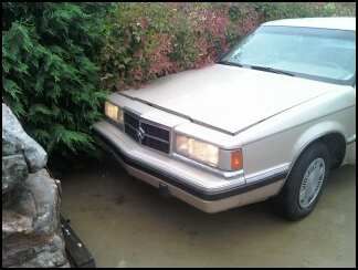

As you can see from the picture, my lights are pretty pathetic. I can barely see the road while driving. So let's do something about that!
