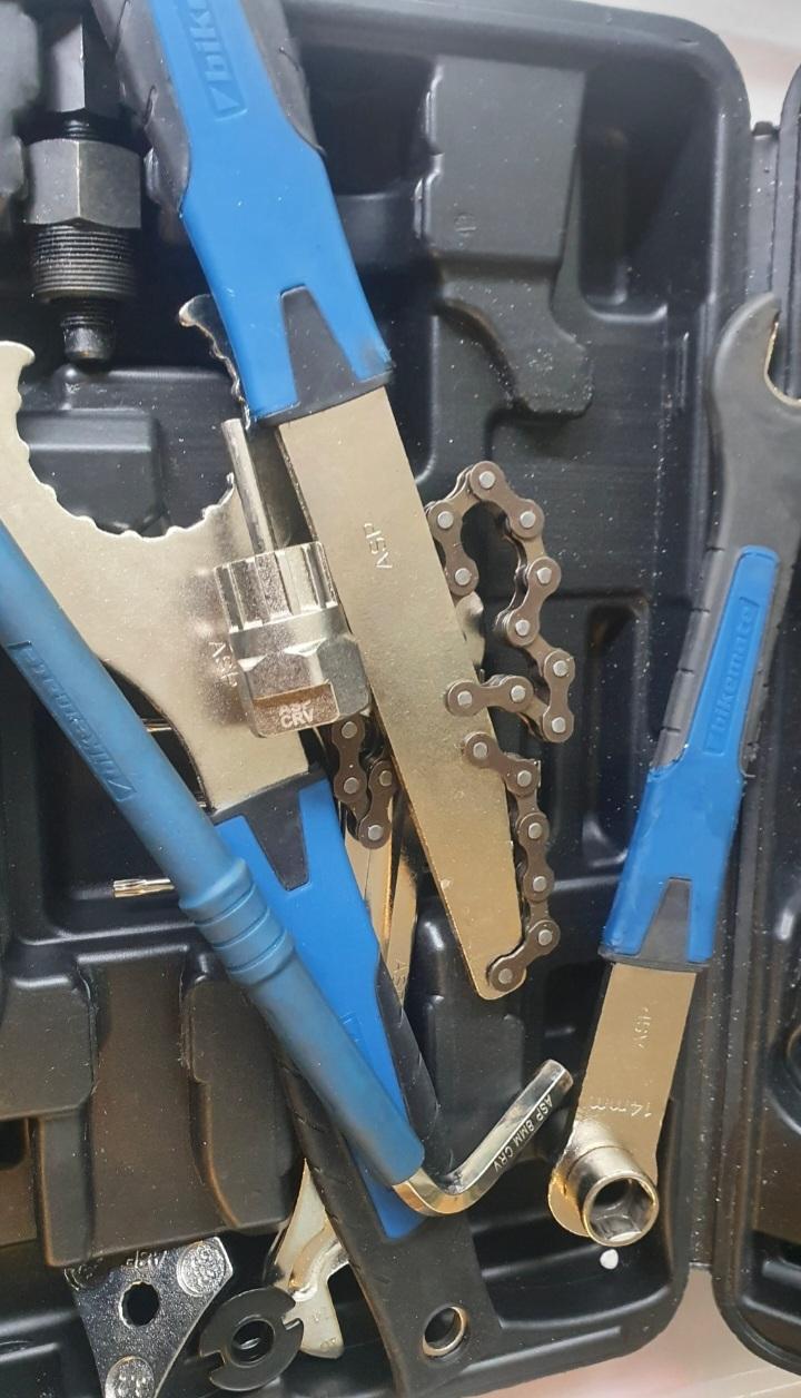

If you don't already have a 'bike tools kit', a sprocket remover and chain whip can be purchased for a modest price.

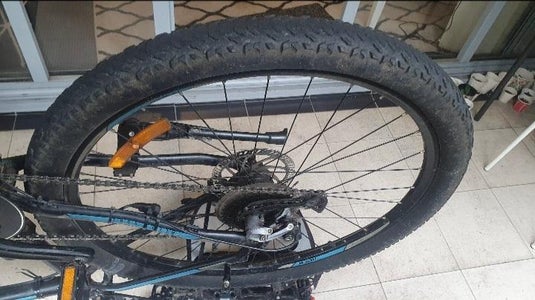

Step 1: Remove Rear Wheel

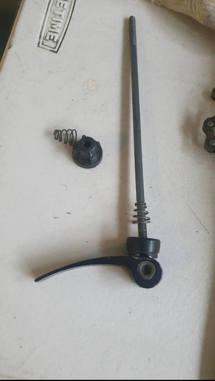

- Remove the rear wheel from the bike.

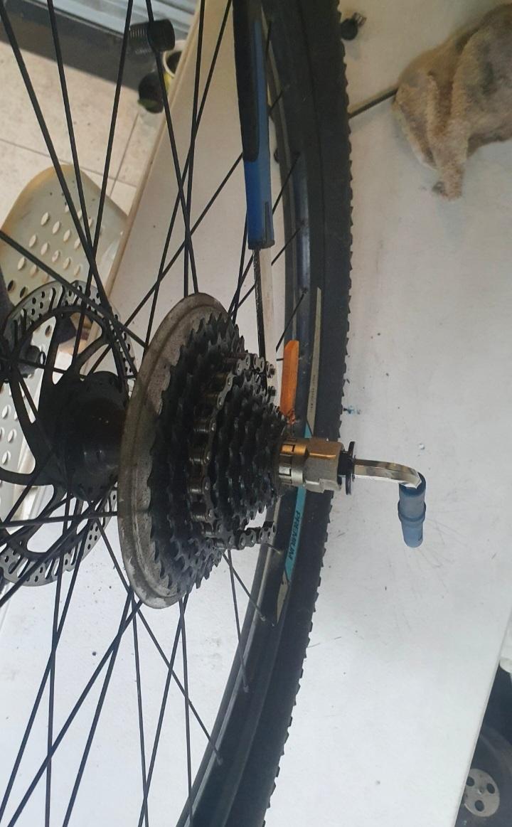

Step 2: Remove Old Cassette
Using a 'chain whip' and the special socket, remove the nut holding the cassette. This may be on quite tight and may require taping the tool's handle to make it move.
- Notice the groves on the shaft - the new cassette fits onto these grooves.

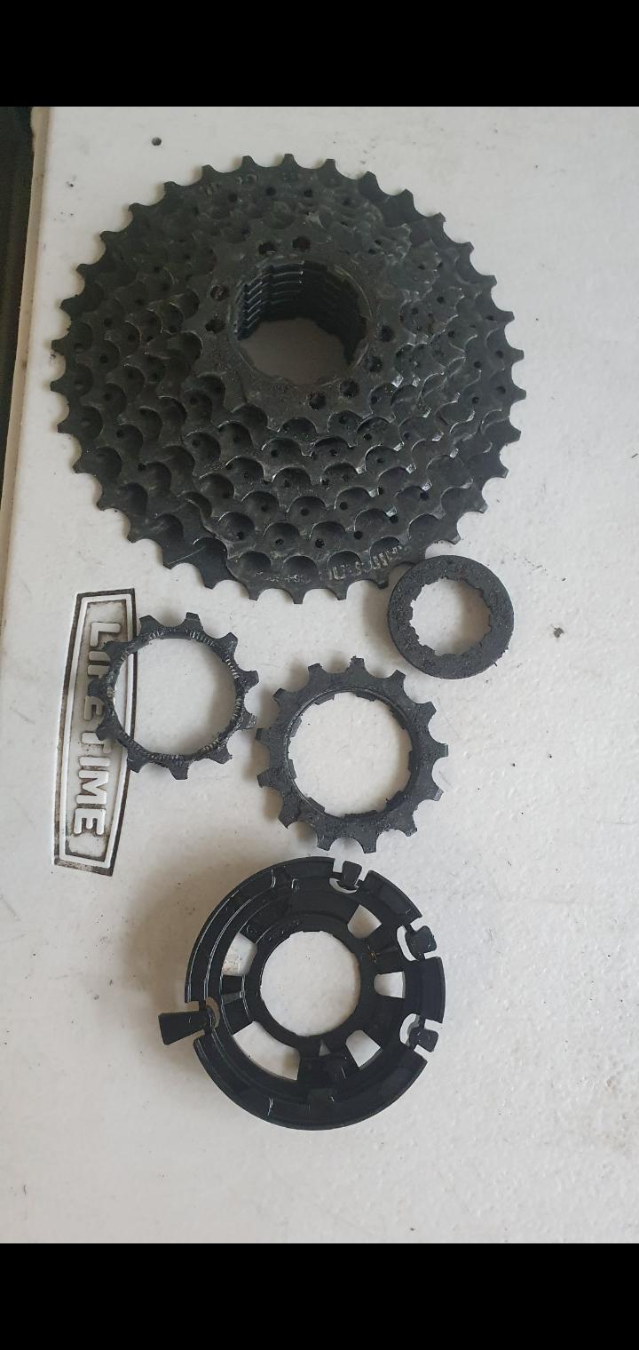

Step 3: Replace With New Cassette
- Install a new cassette by aligning the groves and sliding on.
