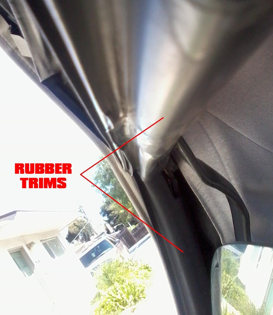

Removal of these will vary for your model. Sometimes they are screws. Sometimes they are "pop out" plastic fasteners, in which case you can gently lift the edge of the trim and work a flat screwdriver toward the fastener, then twist when the tip is close to the fastener. Usually you can hear them "tick" as they start to slip out, but often they will break, so be prepared to buy new ones.
The rear side panels in the Cabrio are pretty clever. There is a single screw into the body that goes into a bar that holds the whole thing in. Access the screw from the front after the seat is removed.
Remove all the rubber trim around the edge of the frames. Once the trim is removed from the rear frame member, you can see where the edges of the top are glued to the frame. Generally you can (gently!) lodge a screwdriver under the leading edge of the trim and work it upward and out of the frame, then "peel" the trim out. They don't go back in quite as easy. :-)
The goal in this step is to just expose where the top is fastened - don't be concerned with the rear trim stick yet, but when you remove the rear inner panels, you should see where the rear trim stick is fastened to the rear of the body by bolts.

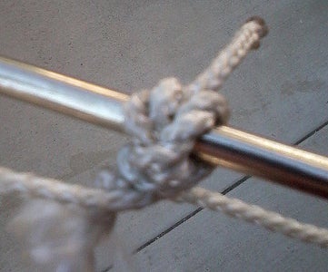

Now tie the ends of the rope in a square knot, and in a second square knot, tie a long screwdriver as shown in the example. Pull your knots tight, and begin turning the screwdriver like the hands of a clock, twisting the rope in a "tourniquet" fashion. You should see the edge of the trim start to pucker a little. Don't twist it tight yet, just get ready.
As this point, realize you won't be able to let go of the screwdriver or it will flip like a helicopter head, possibly breaking the glass. Call in your helper, have them standing by and ready, as what happens next has to happen all at once. Get into a position where you will be able to apply pressure from the inside of the window on the corners of one side. It's tight quarters, so experiment with the best position, remembering that one hand will have to hang on to the screwdriver once you start turning it.
Instruct your helper to stand behind the vehicle and be ready to pull GENTLY at the edge of the window as soon as they see a gap big enough for their fingers from your efforts. From the inside, don't pound on or apply too much pressure to the window, you CAN break it even though it's tempered glass. Try to focus your pushing efforts on the EDGES of the window, not the center of the window. If you're doing it properly, gentle repetitive pushes should be enough to ease the window out.
Ready? Twist the rope up tight again, working your fingers around the edge, making sure the rope stays in under the trim. Don't over-do it or the rope will slip out from under the trim and you'll have to start over. Twist a turn, press the rope around the edge, twist a turn, press the rope - eventually the trim will start to lift high enough away from the frame that you'll be able to tell, if you tighten it much more the rope will slip out.
Now begin pressing gently at the top corner of the glass, then bottom. You may hear creaking noises, especially if any windshield seal was used, this is good. It means you're making progress. Remember to use gentle bumps: put your hand on the glass, push-release, move to the bottom corner, push-release, bump, bump, bump, take your time. Eventually one corner will start to give, remind your assistant to not pull to hard and be gentle. Once one side comes up, the entire window will slide out and you can do a happy dance. The hardest part is over.
** DO NOT REMOVE THE ROPE FROM THE WINDOW. ** Tie a knot in the rope and leave it on the window, you will use it to re-install the window.

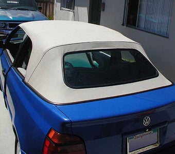

When complete, you should be able to raise and lower the top with very few wrinkles. Almost done!

Step 7: Replace All Trims and Hardware.
Required for this step:
Screwdrivers/screw gun
Silicone spray
rubber mallet
You're just one short hour from cruising with your new top, depending on how much trouble you have with the rubber trims. :-) Replace all the trims and interior panels and rear seat.
I'll tell you right off, the rubber trims are not likely to be an easy task. Some of them you can get to go right in if you spray them with silicone spray on the surfaces meant to slide into the top frame. Others you'll have to work in with a screwdriver or plastic tool, lifting an edge here or there. For the Cabrio, the rear frame trims just wouldn't go from any side - I had to slide them in from the end and tap the rubber, driving it in like a stake. Whatever you do, don't lose patience and start hammering away. Look at how it's supposed to go in, and work carefully. You shouldn't need more than a tap here or there once they are almost in position.
If you bought vinyl top treatment with your new top (you should have,) use immediately and as instructed. DO NOT use Armor-all, use vinyl top treatments only.
Adjustment: You shouldn't need any adjustment, but we noticed a bit of air noise coming from the header at freeway speeds after installing our new top. At the front of the top locks, you will find the hooks are held in by two large bolts. The hooks can be adjusted to tighten the locks if needed. Don't over-do it or you'll prematurely wear out the header locks, crush the rubber seal along the header too much, or break the locking mechanism- only tighten them one "slot" at a time, and only as needed.
One weekend, was that so bad? Use the money you saved to go on a sunny top-down road trip. Enjoy your new top!
