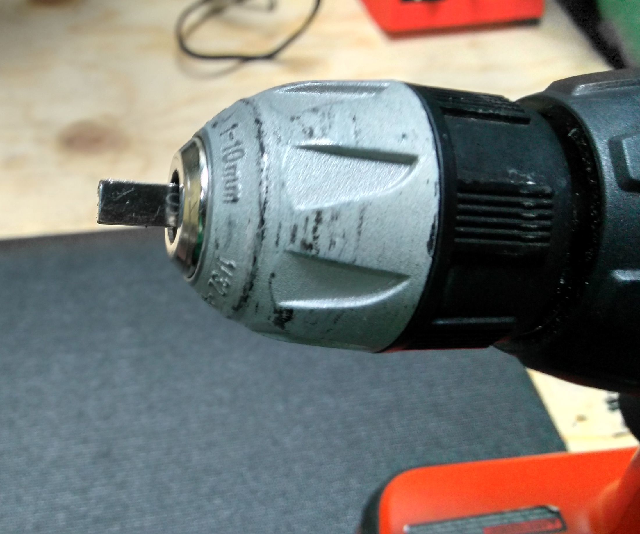

You'll need
1) A #6 and #9 Torx bit
and either
2) Stock compass module replacement
OR
3) OSEPP compass sensor module available at Frys, or any electronic compass that has an I²C connector interface (4 connections; power, ground, data in, data out)
if you choose the last option you'll also need solder, iron and some Gorilla tape.
