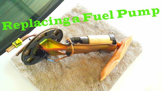

My 1999 honda civic still has its original fuel pump. I have had problems of the engine not starting on mornings when I remote start. As part of my proactive replacement program I decided the replace the pump with a denso pump from Amazon.com.

Carefully sliding the assembly out at an angle the entire unit was now out. I put it on a rag on the trunk lid.
Step 4: Taking Out the Old Strainer and Pump.
Taking off the electrical connector and hose clamps I proceeded to remove the strainer. The tiny spring clamp has to come off first. I used a flat blade screwdriver to do that. Next the plastic strainer came off and the pump itself I levered out.
The denso replacement is identical to the oem.
