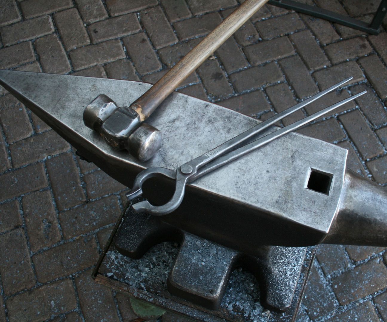

In this instructible I have an example of my own forging hammer of which the handle broke in use.
I thought this was a good opportunity to turn this replacement in an instructible as well.
Do note; the way I show isn't the only way. There are more options than the one I present here.

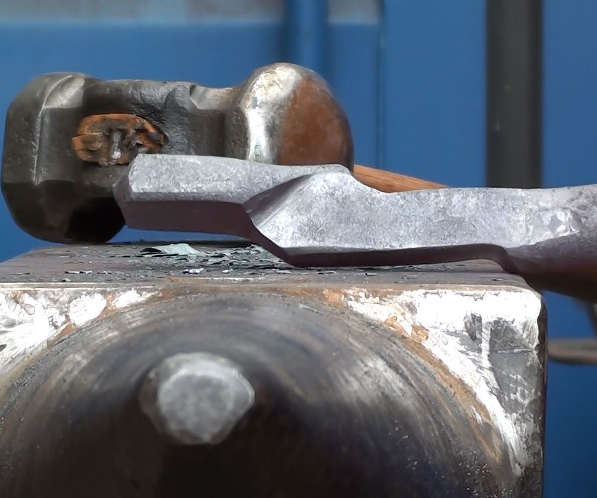

Step 3: Removing the Old Hammer Handle.
I place the hammer in the vise like in the first picture. This gives the old handle clearance so it can easily be knocked out.
I use my hammer eye drift for larger hammers, because the thin end almost completely covers the eye of my forging hammer. This puts a relatively equal pressure on the top of the handle, so it doesn't get compressed.
If I were to use anything smaller, there is a chance the wood becomes compressed and wedges itself stuck.
I would have to drill again, if this happened.
Now with a few taps of the rubber faced the handle is pushed down the eye and comes out.
Anything that else that covers the area of the eye well, should work well too.
If you worry about forgetting what side of the hammer is up, use a bit of soap stone, marker, white out, or anything else to mark with, to mark the "up" part of the hammer.
