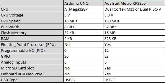

Step 2: Adafruit Metro RP2350 to the Rescue
The Adafruit Metro RP2350 is a tremendous improvement in processor speed and memory size over the Arduino UNO. Check out of some of the more important features of each board above.
The Adafruit Metro RP2350 has the same physical size and shape as the Arduino UNO, and has (almost) the same pinout. More on that later. This allows the Metro to interface with the Arduino CNC shield with very few changes. The following sections describe the changes, some required and some optional, that I made to the sand table firmware and hardware. I am quite pleased with the results.

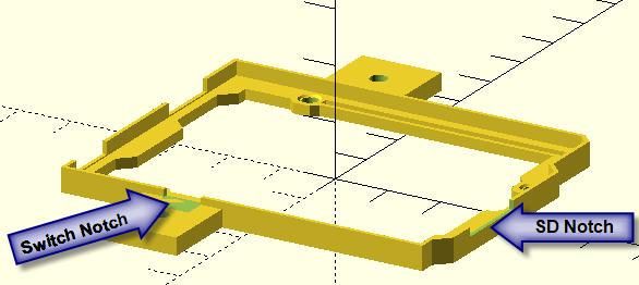

Step 16: Account for Physical Differences
The sand table uses a 3D printed bumper to mount the processor to the base of the table. The Metro RP2350 includes an SD card holder and a power switch among other hardware that the UNO doesn't have. These are physically located at the edges of the card. The 3D printed bumper used to mount the card to the sand table was modified in order to allow the use of the SD card and power switch if desired. The "Metro_2350_Bumper" files reflect these changes.
The Arduino UNO uses a USB-B connector while the Metro RP2350 uses a USB-C connector. This required the face plate USB hole to be slightly lowered and re-sized to accommodate a USB-C connector. The face plate USB hole was lowered by 2 mm and its height reduced to 10 mm. The "Faceplate 2350" files reflect the changes.
