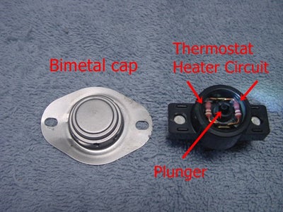

Step 7: Thermostat
If you were wondering what was inside the sealed thermostat, not much. A circuit from the side terminals identified as a “heater” circuit and a circuit from the end terminals that turns the dryer’s heater element on and off.
The thermostat is a simple bimetallic cap that deforms inward when heated. When it deforms, it pushes the plunger against and lifts the spring arm. The contacts are disconnected, the circuit is broken, and the heating element is turned off. When the cap cools sufficiently, it reforms and allows the plunger to move back. The spring arm closes, the contacts are connected, the circuit is made, and the heating element is turned on.
There are two failure modes.
The contacts fail to close and the dryer will not heat. You will find no continuity on the end terminals if you test it.
The contacts fail to open and the dryer will constantly heat. You will find continuity on the end terminals if you test it.
Every time the dryer lost the capability of selecting temperatures, it has been #2.
