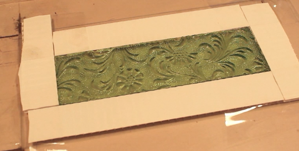

Step 1: Preparation of Sample Piece

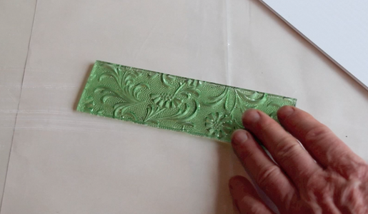

I’ll start by removing and cleaning the example of pattern glass I would like to reproduce. I am going to place some modelling clay or plastic signboard material around the perimeter just slightly lower in height than the glass thickness. This will provide even edges which will be easier to cut off the finished piece later. Cracked pieces can carefully be fit together and the modelling clay helps to secure them in position.
Step 2: Making the Mold Dam

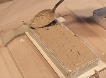

Now the sides need to be built up to contain the cement casting. I usually make the sides 3/4" wider than the piece of glass I am going to reproduce. I usually use the Coro-last signboard material for this and tape it together like a rectangular box about an inch high.

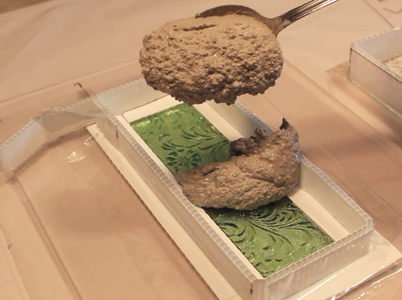

Step 3: Mixing the Refractory

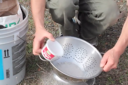

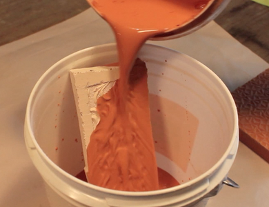

Next I am going to sift the refractory mix through a kitchen colander to remove the larger pea-sized pieces to produce a finer detail. I mix the refractory powder with just enough water to make it fall off a spoon when held on it’s side. Too much water can weaken the mix, too little water can cause uneven setting. Before placing the mold material, I spray the glass lightly with a silicone mold release which oils and “wets” the surface which makes the material flow better with less potential to trap air bubbles in the small areas of the design.
The castable refractory I use for this sort of mold making is the 3000f dense castable and it is available through refractory suppliers which have an outlet in every major city and industrial town. The cost is comparable to plaster, approx $5 for a $50 lb sack. It does have a shelf-life and absorbs moisture so it is recommended to buy it from a supplier, not an online reseller dispensed into smaller quantities of unknown storage conditions or dates.
Step 4: Pouring the Mold
After filling the mold with approx. 3/4 inch of the castable material, I vibrate it by pressing the back of the spoon down into the wet mix until I can feel it knocking the glass, repeatedly and over the entire surface. This forces the heavier material under any trapped air bubbles.
I set it aside to harden for 24 hrs. Then I can strip off the dam sides and carefully remove the glass. Now the mold needs to air-cure for at least 5 days before firing to 1400f at 300/hr. After the mold is fired and cooled I can examine it to see if there are any areas where I need to gently scrape off thin lines caused by the fitting of cracked pieces, etc.

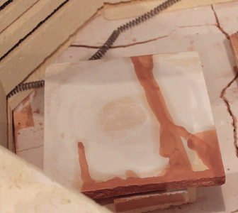

Step 5: Coating the Mold
 Now I pour a thin mix of shelf primer over the mold as a release so the glass won't stick. Pouring instead of painting the thinly-mixed shelf primer ensures there are no brush strokes left in the mold.

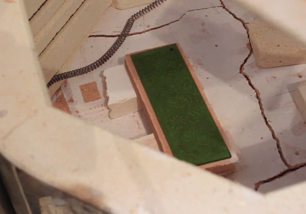

Step 6: Press-firing the Glass

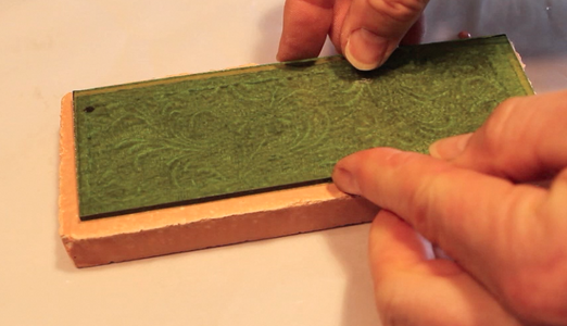

Now it is ready for my replacement glass. In this example I am using a different (darker) color of green because I would like to indicate which is the original and which is the copy. I cut a piece of glass at least 1/2 inch wider than my molded piece and place it on the mold. Then I place a piece of primed kiln shelf or bisque-fired ceramic tile on top of it. This bit of weight prevents the edges from pulling in and thickening and it also helps to press the glass down into the design areas of the mold without becoming elevated by trapped air.  I fire these to a full 1500f to ensure the glass has taken up all the fine detail. If the glass didn't have a flat surface sitting overtop of it, the glass would tend to pool up on the mold during the hot firing. The little bit of weight helps the glass stay spread out and slowly forces it down into the fine detail.
(A word about “press-firing”. Too much weight contributes extra mass to the firing and will lengthen the time required to reach useful temperature, because all that extra mass also needs to become just as hot as the mold and the glass. Also, the extra mass can result in uneven cooling because it will hold more heat and longer as the surrounding mold and kiln cools. The glass doesn’t need much weight at all, it will press down and conform to the mold details when it reaches the melting point. The work being done is more a result of time and temperature than pressure.)

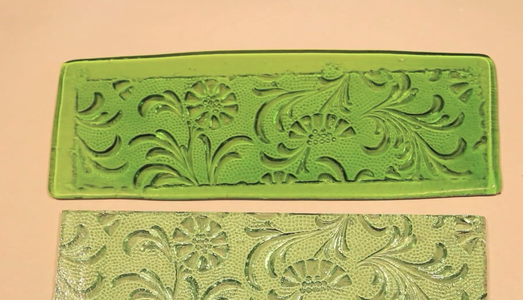

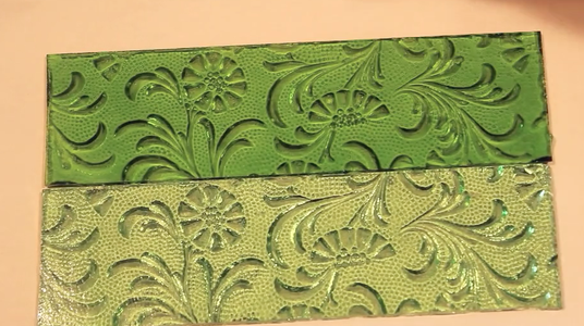

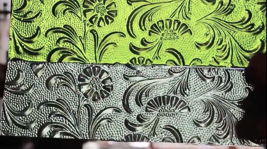

Step 9: The Finished Replacement
Which one is the original and which one is the copy? The darker green is the copy.
