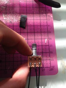

This is an additional step that I have started using for my builds, it may not be 100% necessary for you depending on your soldering skills and the type of potentiometers you are using.
Whilst prototyping this build I kept running into a strange problem where everything would work perfectly when laid out on a breadboard but as soon as I started soldering, the potentiometers would stop working and start returning random values. After a lot of trial and error I found that the problem was caused by the potentiometers becoming too hot when I was soldering the wire to their terminals. This was leaving them looking fine on the outside but completely fried inside. Now as a precaution I add a small bit of strip board to each one so I am not soldering directly to the pot itself. Since doing this I haven't had any problems.
To do this you need to cut a small piece of strip board to 5 holes wide by 4 holes high, with the copper traces running vertically. This must then be soldered to the potentiometer as pictures.
To this piece of strip board you will then need to solder 3 pieces of wire (one for each terminal on the pot). It's best to be quite generous with the length of wire as you can always cut it shorter before soldering it to the main strip board. You need to do this for all three pots. Make sure that you match the trace that you are soldering the wire to with one that is attached to a terminal on the potentiometer.
If you choose to skip this step just carefully solder the wire to the potentiometers terminals applying as little heat as is necessary to get a solid connection.
