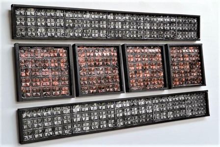

I try and create all my projects from recycled materials. In our house, we all love Pepsi Max, which leaves us with a fair few aluminium cans. Instead of sending them to the recycling centre, I wanted to try and create an aluminium can wall hanging with them. Because aluminium cans are not very big, I wanted to create a wall hanging that was made up of smaller panels that could be arranged in different designs on the wall. So your wall hanging can be changed around when you get bored with the design.

To prevent the wax paste from going dull over time you need to seal it with 2 coats of clear spray polyurethane. This is where I originally stopped, but when I was taking the photos they looked unfinished.
Step 13: ​Making a Frame
I went for a very basic frame, by cutting some wood strips 1cm thick from 2 cm wood, and painting it black. I used glue and a nail gun to attach the frames to the panels. If you don’t have a nail gun you can clamp the frame in place while the glue dries.
Step 14: Arrange the Panels
It looked more complete with the fame. All you have left to do is create your aluminium cans wall hanging layout on your wall. You can move them around until you are happy with the design.
