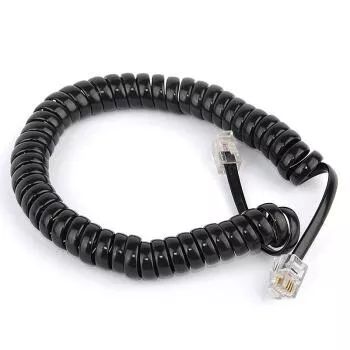

Based on my sketches and ideas, I set out to find the curved hollow tube that I needed to wind around the phone. After some digging at my local reuse store I was able to find these two stainless steel shower head pipes and an escutcheon all of which were somehow in near perfect condition. This was a great find, the only issue was that the two pipes needed to become one solid piece.
I also had seen that the rotary phones wire was torn and dirty, so I decided to replace this small brown wire with a black spring cord from the reuse store in order to have the wire sit better and have improved reach with the phone in hand. I also remembered that I had this old pine chest that had been sitting around my house for about a year that I had found in an old barn during a demolition to reclaim salvageable barnwood. I realized that the lid of this chest could make a perfect height for a stand, and the finish on it was strikingly similar to the phones felt base along with the brass patina corner caps that related to both the tarnished rotary phone and shiny steel pipe.

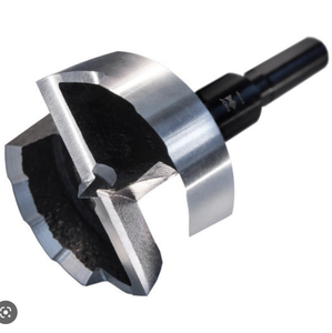

Next, I got a drill with a 1/2" diameter forstner bit (pictured above) and drilled a hole the same size as the shower head pipe where it would need to be to leave the right amount of space between the phone and rod. I additionally drilled two smaller holes where the phone could be fastened to the stand and remain centered.

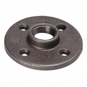

Once the epoxy dried and the two pipes were in one piece, I needed a way to connect the bigger resulting pipe to the wood stand. A floor flange was the perfect solution to this problem. I used 4 screws to fasten the floor flange to the underside of the wood stand, being careful to insure that the pipe would screw tightly into place when facing straight forward over the phone.
