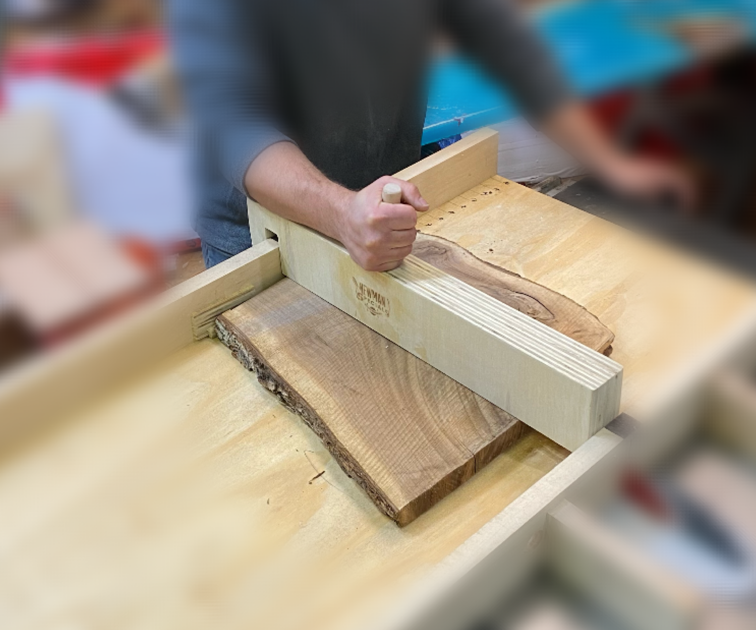

In order to cut the board down the middle you need to find the middle of the board. There are several ways to do this - I simply use a a square to determine the width and then find 1/2 of it. I set this to the middle of my table saw blade from the fence. The image for this step is the

In order to get a cut into the board there are things to remember
1. Cut one side, then flip the board and over so you keep the same side of the board against the fence
2. Cut in multiple steps - don't try to raise your saw blade to maximum height and cut it all at once. I tend to cut in 1 inch increments
I use a feather board to help hold the board firmly against the fence. When you are done with this step you have a board with a cut on each side and wood still in the middle
