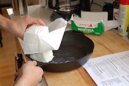

Step 2: Pan Meet Lard
I unwrapped my lard block (aka porky crayon) and gave the entire pan a nice coat. As I mentioned in the previous step the instructions I found online suggested you also lightly season the outside of the pan. So both sides got a nice coat of fragrant lard. This was a pretty simple step but clearly the most fun part.
