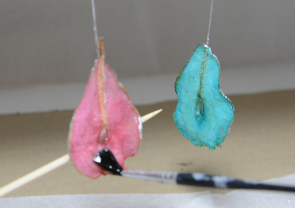

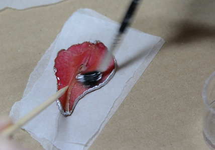

Step 5: Clear Resin
Mix the smallest amount of clear resin (about one tablespoon) and apply it with a brush. Cover only one side of the slice, the one without any thread. Hang the slice up using tape or blutack.
Use a skewer to hold the slice steady in the air and apply a small amount of resin to the other side of the slice. Apply only to the bottom part and leave the top part with the thread resin-free.
Step 6: Hardening
Once resin has hardened, you can take the slices down and gently remove the thread.
Then, you have to mix a small amount of resin again and apply it to just the top of the slice, where the thread used to be, to harden that part as well. You don't have to hang the slices up again, you can just let them lay flat.

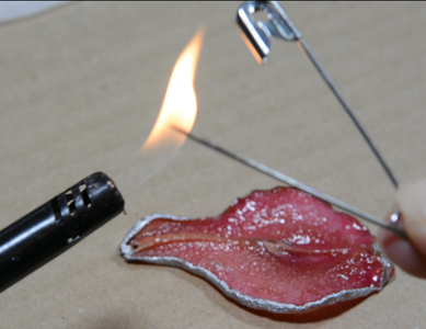

Step 7: Holes and Hooks
Once all slices are hardened, you have to make a hole for the hook. The best way is to find a thick metal needle or a pin, heat it up with a lighter until it glows and push it through the pear to create a small hole.
Thread the hook through the hole and you are done.
