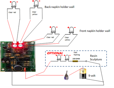

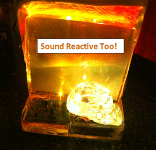

1. Sound to light skull napkin holder

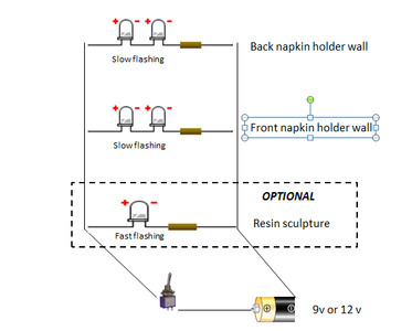

2. Plain flashing light napkin holder
3. Waterfall napkin holder
Velleman Sound to Light Kit. I found this at my local Fry's store for less than $5. It comes with a 9 volt battery holder. Refer to the Additional Info for Sound to Light Napkin Holder Section.

4. Prepare the LEDs to be used.
I marked the cathode of the LEDS with black marker. I used masking tape to tape the 2 LEDS (side by side) to the side of the sandwich holder marked with an X. The 2 LEDS will be connected in series so the cathodes were placed on the same side (so the anode of the first LED will connect to the cathode of the 2nd LED).

7. Wire the LEDs. Refer to the LEDS and Wiring Section for additional details. Be sure to test it!

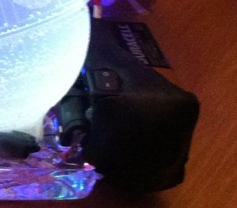

If the battery sits in between the walls of the napkin holder, then create a thin flat battery cover is required.
I was able to create one using Woodland Scenics Water Effect. Take a piece of parchment paper, and paint a retangular piece of the Water Effect using a brush. Use a fairly thick amount of the Water Effect. After it has dried, peel it from the parchment paper and trim it to size to fit over the hole. Take some of the water effect and apply it like glue to one edge of the hole, and attach the cover (refer to picdtures). This will create a flexible flap. I was also able to add a little bit of alcohol ink to give it a blue color. The water effect will dry translucent.
You may also try cutting a piece of clay to fit the size of the hole to make a cover.

I attempted to use a 9 volt battery holder (either with or without a switch) and found it to be too large. I opted to use a battery holder clip instead to connect my 9 volt battery.
I also used a 12 volt battery holder in some cases because it is so much smaller than the 9 volt battery.

Where to place the switch
I also experimented with different areas to place the switch.
Set the switch on top of the resin
In the first picture, the switch was placed on top and resin was poured around it to keep it in place. When using this method, be careful that the resin does not get into the switch or else it will be stuck in position and you won't be able to flip it on/off. You may try to add putty around the switch to prevent resin from seeping in.
Set the switch on the side of the base
The switch can be glued to the side of the resin base.
If the cardboard battery case holder is placed close enough to the side walls (so that there is a sturdy yet thin wall), then a hole may be cut in the sides to insert the switch through (refer to picture). The switch would then be glued from the inside of the hole. I find this to be the nices place to put the switch.
Set the switch inside with the batteries (not pictured)
The switch can be glued inside the battery holder area. Create a long enough cardboard box holder so that both the battery and the switch be be placed within the sunken hole.

Step 3: LEDS and Wiring
DISCLAIMER- I'm a novice with LEDS and electricity (with information gleamed from 'Hacking Electronics' and 'Make:Electronics' ) so the information may not be 100% correct :( Please be kind. I did verify the napkin holder lights were all functional! Even witness it glowing for few hours at a party.
LEDS and Reistors
Each napkin holder wall had 2 LEDs and a resistor. The 2 LEDs were wired in series and a resistor was added on the negative side (except for the Sounds to Light kit. Refer to that particular section regarding the wiring).
The 2 walls were then wired in parallel (refer to the diagram).
Optionally, additional LEDs and a resistor were added to the resin sculptures (refer to the OPTIONAL portion of the diagram). If 2 LEDS were used in the resin sculpture, they were wired in series and the resistor was added on the negative. These were then wired in parallel to the 2 walls.
I used mostly slow flashing and fast flashing LEDs (3.0-3.6v forward voltage, 20 ma forward current) ( http://www.amazon.com/microtivity-IL604-Slow-Rotating-Resistors-Pack/dp/B007RO9X82 ) and either 9 volt battery or 12 volt battery.
Here are the resistors I used depending on the number of LEDs and battery used to go with the diagram:

LEDS and Reistors
2 LEDS in series + 200 ohm 1/4 watt resistor for 9 volt battery
2 LEDS in series + 300 ohm 1/4 watt resistor for 12 volt battery

Step 5: Additional Info for Sound to Light Napkin Holder
I love this Velleman Sound to Light kit that I found at Fry's for under $5. I also saw them on Amazon at a higher price. You can also find the schematics online if you want to build one yourself (http://www.vellemanusa.com/support/downloads/?code=MK103). It was fast and easy to solder and the circuit board was the perfect size for the napkin holder.
Kit Modification:
I modifed the kit slightly:
1. I substituted 2 clear red and 2 clear yellow LEDs for the 4 solid red leds in the kit. The 4 LEDs in this case are connected in series so be careful in substituion of LEDS. It runs off of 9 volt batteries. The red and yellow ones I used have a forward voltage of 2.2 to 2.8. I believe the flashing leds as well as blues and greens have higher forward voltage so I could not substitute them using 9 volt battery.
2. I did not solder the 4 LEDS to the board as the instruction indicates. Instead, I soldered wires to the positive and negative LED slots. I marked the negative wires with a black marker to help me wire them to the LEDs in the 2 walls later.
3. I did not use the battery holder that came with the kit because it was too large. Instead, I created a cardboard box around the 9 volt battery itself (refer to the Battery Section), and used a battery holder clip instead (see picture). Make sure to tape the cardboard well with the packaging tape.
Wiring:
When I soldered the components to the board, I did not solder the battery holder clip directly to the board. Instead, I soldered 2 wires that will be connected to the battery later. So the assembled board contained all the components except the LEDs and the battery leads (wires were soldered in the slots instead).
After soldering the components in place on the board, I wrapped the wires (did not solder because testing only) from the LED slots on the board to the 4 LEDs and tested it to make sure it worked before continuing!
Wiring the LEDs within the napkin holder walls was also done differently than the other napkin holders. I soldered wires to each leg of the LEDs (I didn't connect them together in series). The wires from the LEDs that were embedded in the walls were later joined to the wires coming from the circuit board (see diagram).
Additional Skull resin sculpture for battery cover:
I also added 2 flashing LEDs to the Resin Skull that was used as a battery cover. I connected the skull LEDs in series with each other and added a 200 ohm resistor on the negative side. I then wired the leds from the resin skull to the postive and negative lead of the batteries (see Optional portion of the diagram).

Kit Modification:
Wiring:
