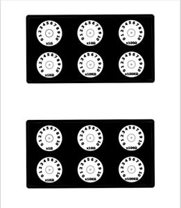

Step 3: Labeling
So you would think we are starting to build this box, but there is still somethings to do. First we need to make a sticker that we can both use as a drill guide and the final label on the box.
For this I used adessive back paper that allow you too print onto, peel of the backing and stick. Think they call it label paper. I copied my box top to inkscape to not have to figure out where my holes where all over again. I printed two, one to act as a template to accurately drill the holes for the rotary switches and a second one that will be the actual label. This means is can completely ruin the first one with the drill, peel it off and just replace it. Professional look? Check.
I also made a drill template for my banana sockets on the side. More hours spent on design means less hours in the workshop drilling, more time to drink tea.
Too make the label that will stay on the box, I took clear vinyl covering and stuck it over my sticker before cutting. Here is where patience is key too prevent air bubbles on the label. If you do get air bubbles that is not excessively large you can poke a hole in it with your scalpel and use a hairdryer or a heat gun to soften the vinyl and push it down. i used a soft tip scraper and worked from one side to the other in small diagonal movements. Key takeoff here is to take your time.
After the vinyl is on your label, go ahead and cut it out.
Now I can see a lot of comments about how I copied the box sketch to inkscape from fusion. I had to call a guy who cuts our window gaskets for help. The simplest way he found was to create a new sketch in Fusion and project the top of the box and the side with the plugs onto that sketch, right click and save as DXF.
I then open this DXF file in inkscape and only set the manual scale factor to one(1). Next Shift+Ctrl+D will open the document settings, almost at the bottom at the scale tab (Scale x:) add a 1 to the end of all the zeros. This worked fine for me. (Thanks Greg)

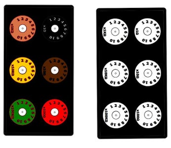

The label is below if you want too use it as well. I'll include the svg file too if you want to cut it on your laser cutter/vinyl cutter.
After I printed everything I realized that I did not add a 0 to the scale. You get the fancy new label.

- After I built everything I realized that my label was missing a 0 and the divisions where not the same as the rotary switch's clicks. I found a program that makes the making of fronts for these projects much easier. I'll link them here.
