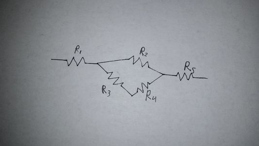

Step 4:
The first image shows that the only resistors in
series are resistors R3 and R4. Because of this, those resistors can be combined into a single resistor.

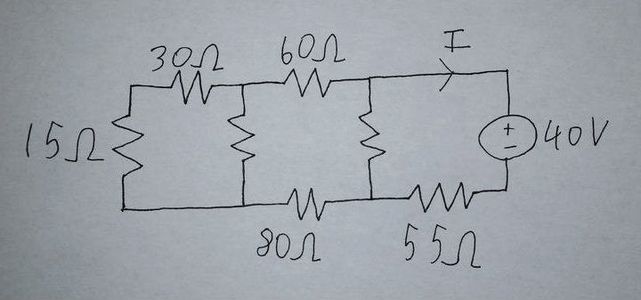

Step 9: Example Problem
First, find the final equivalent resistance of the circuit (reduce the system to one resistor and the battery). Then, find the value of the current I.
The black values are the initial values of the resistors and battery.
Step 10:
The values that are boxed in red are the values
of the resistors that are to be reduced into a single component in the next step. In this is instance, the 15 ohm and the 30 ohm resistors are the ones to be combined using the Series Equivalent Resistance equation.
NOTE: It may appear that the 15 ohm and 45 ohm resistors are in parallel. Even though they do share a loop, the connection they share is also shared by the 30 ohm resistor, making the connection invalid. Also, don’t mistake the 30 ohm and the 60 ohm resistors to be in series. Those resistors do share a single node. However, the node is also shared by the 45 ohm resistor.

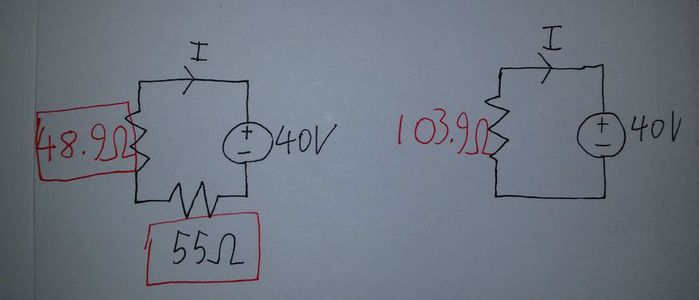

Step 14:
For the final equivalent resistance, the 48.9 ohm and 55 ohm resistors will be reduced using the Series Equivalent Resistance equation.
Now that you know the final equivalent resistance of the circuit, you can use that to find the current of the system using Ohm’s Law, V=IR.
Solving for I you get, I=V/R. The current, I, flowing through the circuit is determined to be about .3849 amps or 384.9 milliamps .

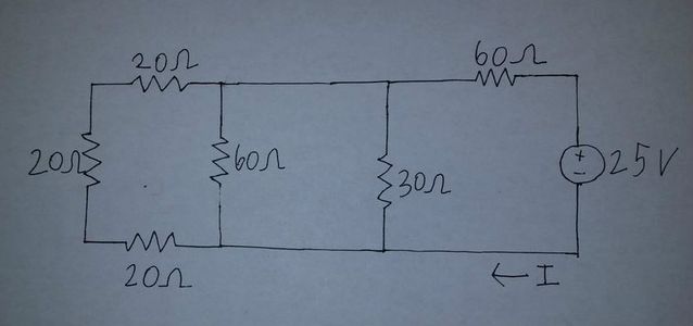

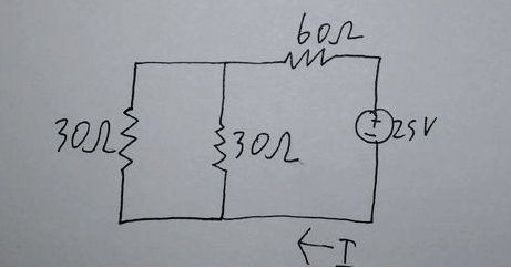

Step 15:
Now try the next problem on your own. Remember: When reducing the circuit, it always helps to redraw the circuit with the new equivalent resistors in between each step that you take.
Step 16: Answer
Answers: Req = 75 ohms, I = 1/3 A
