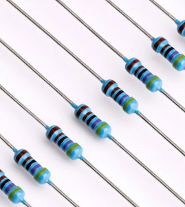

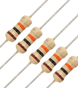

Step 2: Example
Ok so, right here I have a 5 band resistor and a 4 band resistor. The 5 band resistor is a 10k resistor and the 4 band resistor is 4.7k resistor. We know that this resistor is a 10k(5 band-blue) resistor because of the colors on it. We can observe that the colors on it are: brown, black, black, red, and the tolerance color is brown. The same process goes for the other resistor. We can observe that the colors on the 4.7k resistor are: yellow, purple, red, and the tolerance color is gold.
