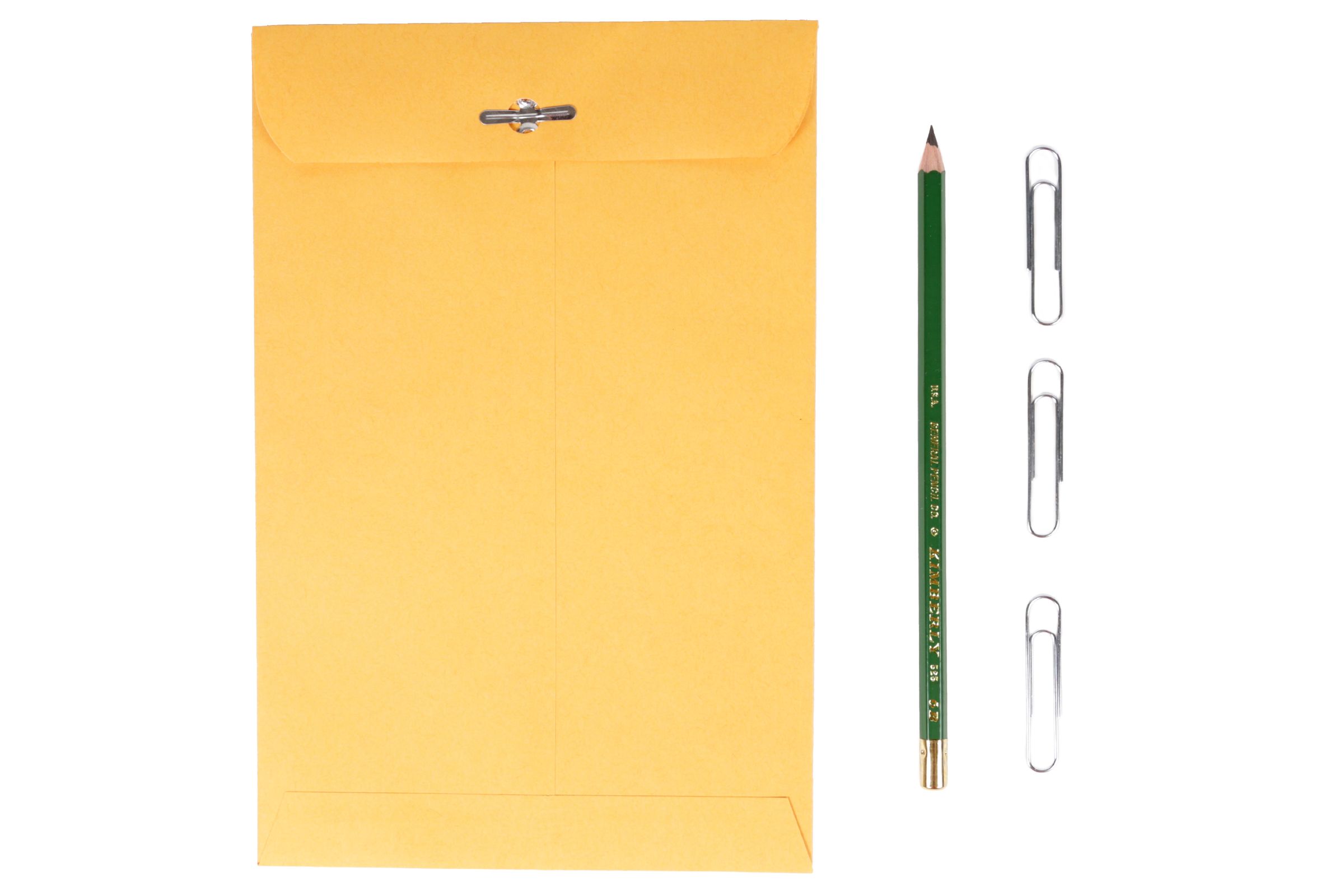

While it is optional, if you want to follow along at home and make a paper resistor you will need:
(x1) pencil (preferably 6B, but a #2 will work)
(x1) Paperclips
(x1) 6" x 9" envelope (or piece of paper)

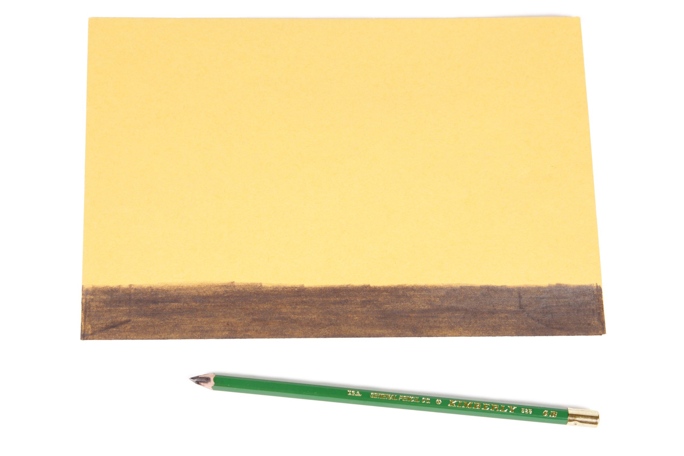

All we will need is a pencil (a #2 will do fine, but a 6B is better), a sheet of paper, and some paperclips.

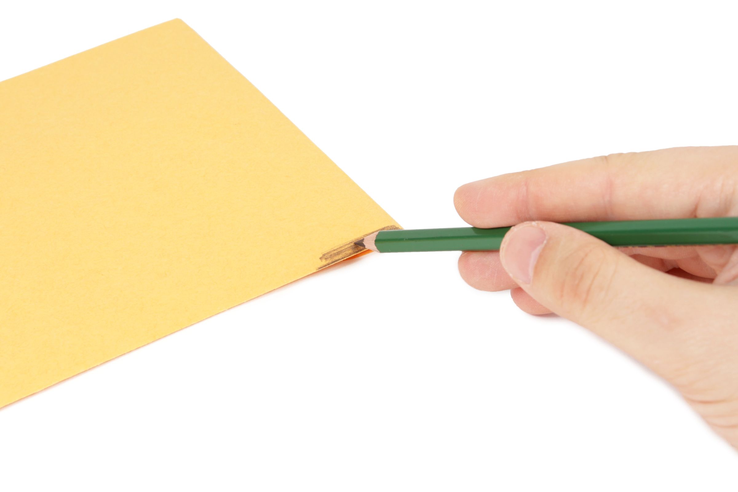

Take a 6" x 9" envelope and turn it sideways, and then rub a pencil back and forth along the edge. Create a one inch wide band of graphite along this edge. Once you are think you are done, keep going. The more graphite you can put down onto the paper, the better your resistor will work.

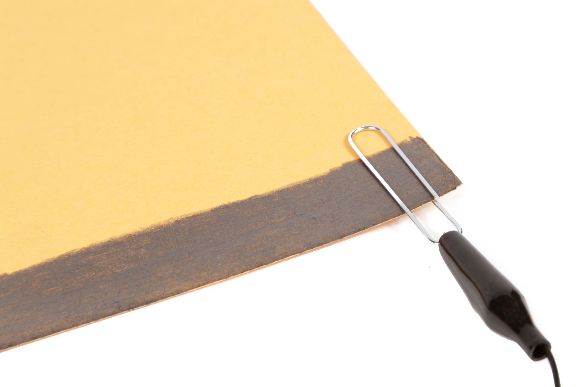

Attach paperclips to the probes of your multimeter using jump cables.
Attach one of these paperclips to one corner of the strip.
When you touch the other paperclip anywhere on the strip, you will notice that you get a resistance reading. Congratulations, you have made a resistor.
Now, attach the second paperclip to the opposite corner.
My resistor gives a reading of about 500,000 ohms. I arrived at this because the multimeter is reading in the 2000K (hundred thousandths) range. Thus, it is giving a reading of 500K ohm. Your resistor should roughly be in this range. If your resistor reads much greater than this, add more graphite to increase its conductivity.

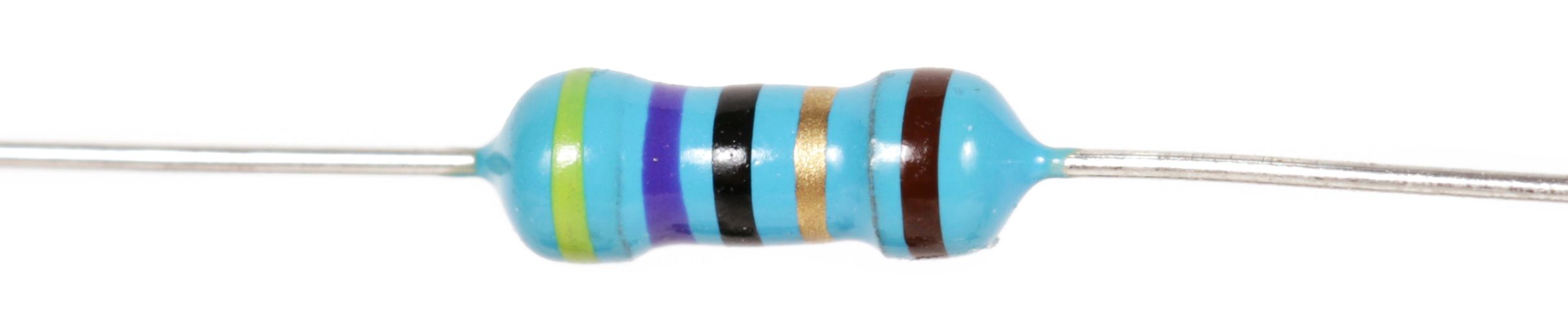

Determining how much resistance a resistor offers is a little trickier and can be established by deciphering the colored stripes from left to right towards the tolerance marking. You will typically see four stripes, but you may also encounter resistors with five.
Resistors with four stripes are the most common. These will likely be the type you are working with most.
When reading a resistor with four stripes, the first two stripes are combined together to form a number between 1 and 99. The third marking is the multiplier. The last marking determines the tolerance, which will be discussed further in a moment.
For instance, in the following example, the first two lines represent 1 and 0, which is combined together as the number 10. This is then multiplied by 10,000 (which is the multiplier). The result is 100,000Ω.
However, when a resistor is 1,000 or more ohms, we measure it in kilo-ohms. A kilo-ohm is basically equal to 1,000 ohms. So, 100,000Ω is shortened to 100kΩ. Basically, it is 1,000 ohms times 100. All we are essentially doing is removing three zeros from the number, and replacing them with with k.
If that was confusing, let us look at another example. This resistor has the same initial number of 10, but a multiplier of 1,000. When multiplied together, these numbers yield a resistance of 10,000Ω or 10KΩ.
Now, let's say the first two numbers were to change, and the multiplier were to decrease. In this example, the first two colors when combined create the number 68. When multiplied by 10, we get the number 680. Since 680Ω is less than 1,000, we just call this resistor 680Ω.
One last thing, if there is a million or more ohms, we then measure in mega-ohms. For example, this resistor is worth 1,000,000Ω. This is shortened to 1MΩ.
Resistors with 5 stripes are a little less common, but just as easy to read. Let us briefly consider how to read them. Like the 4 band resistor, you first find the tolerance marking on the far edge, and then read left to right towards the marking.
However, where they differ is in that the first three stripes get read as a single number, and the fourth stripe is the multiplier. So, in this case, we can determine the first number is 100 and it gets multiplied by 1,000, giving us a resistance of 100K.
The fifth stripe is the tolerance marking.

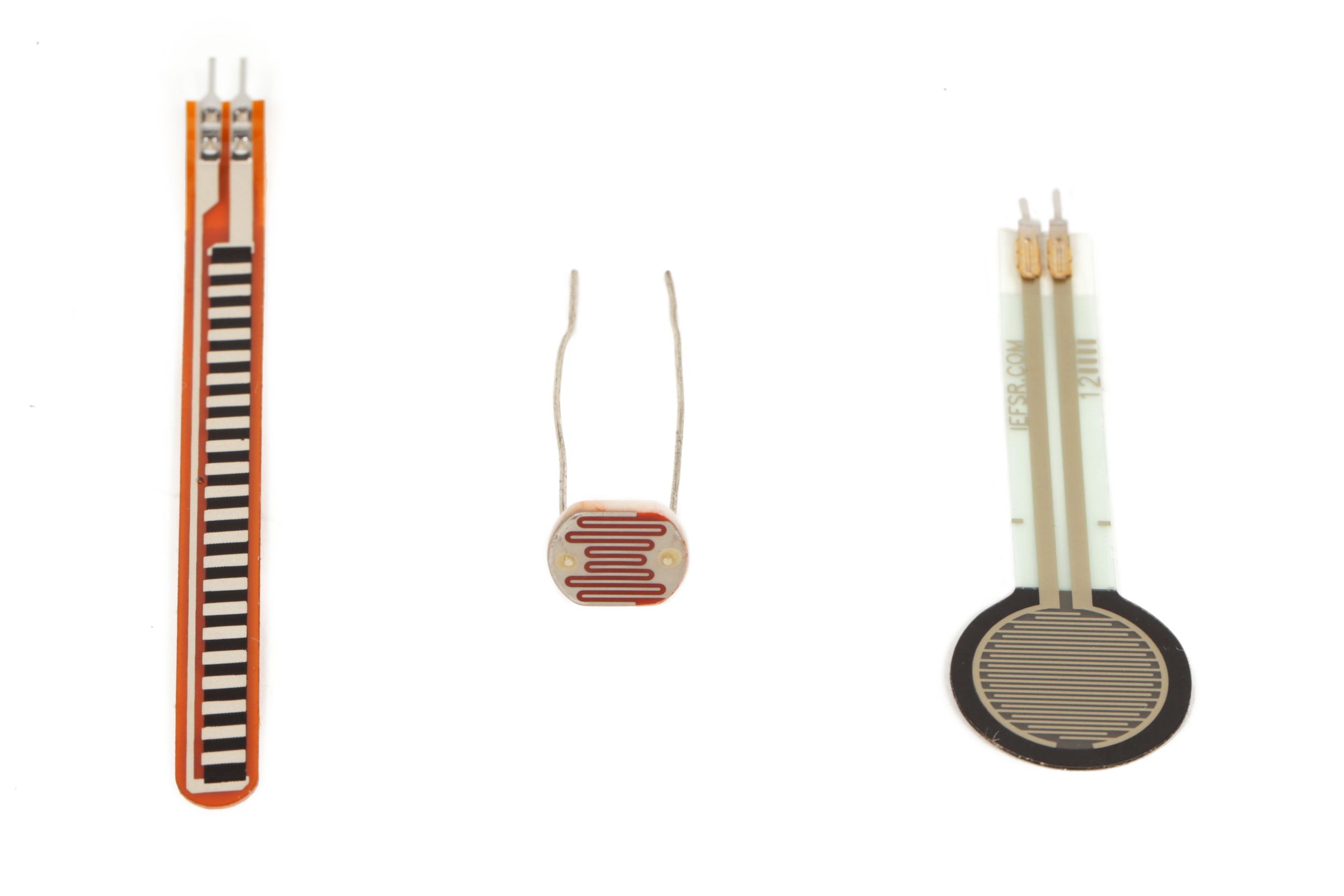

Some of the most common types of variable resistors you may encounter include photocells which change in relation to light, bend sensors which change in relation to being flexed, and FSR (force sensing resistors) that change resistance when you apply pressure upon their surface. You also might encounter a host of other variable resistors that change in relation to heat, moisture, and gas, to name a few.

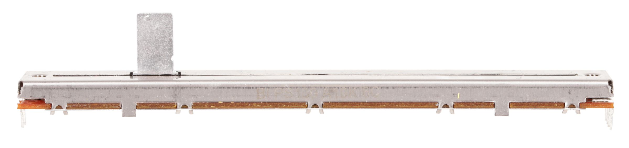

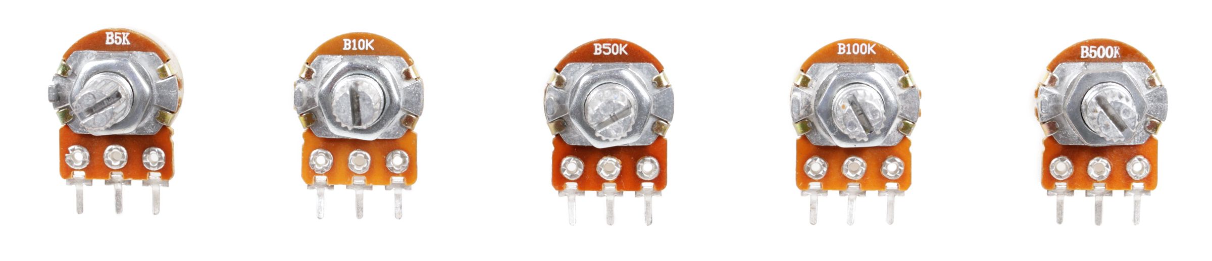

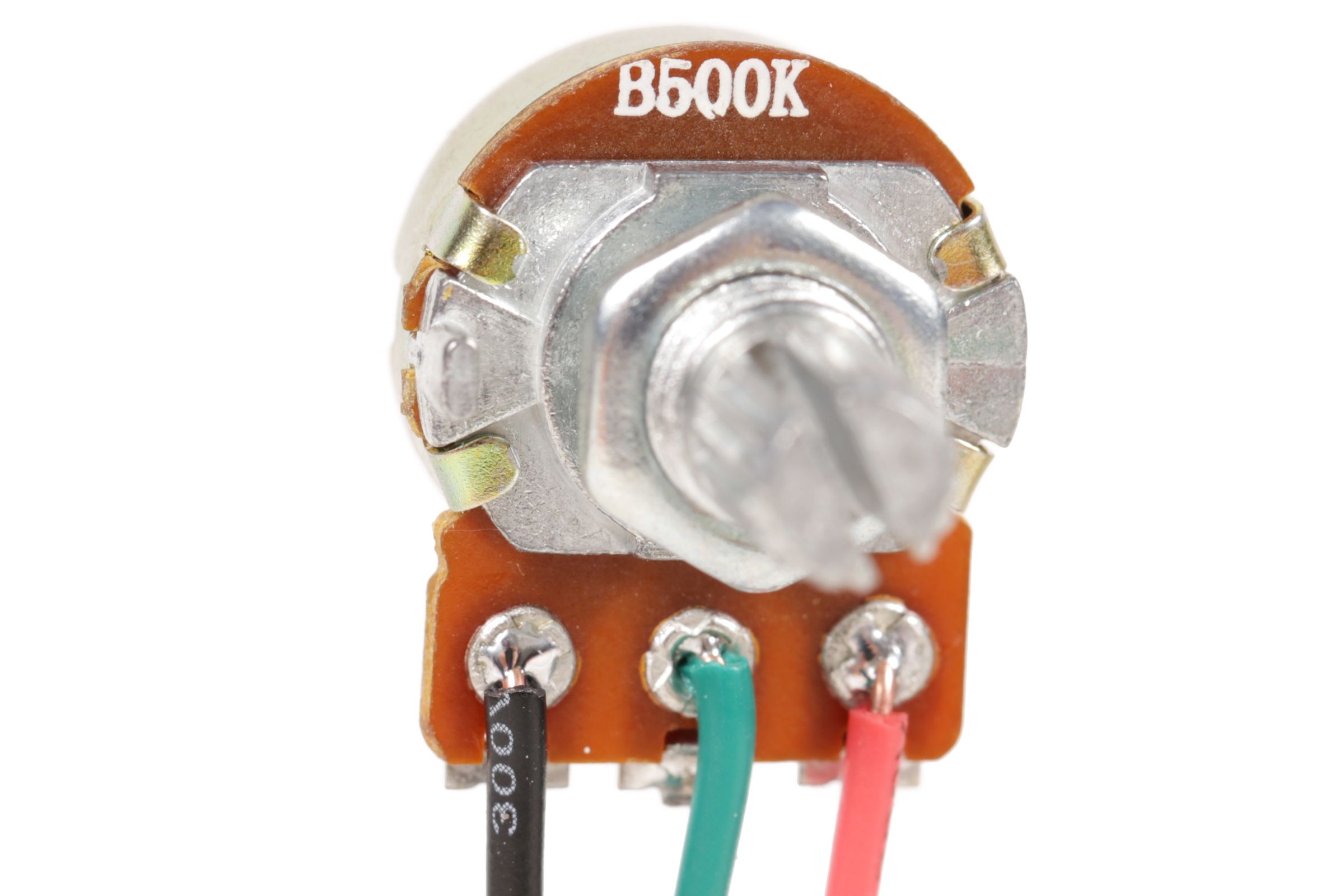

Most importantly, there is the potentiometer. This is the most common variable resistor and utterly ubiquitous in your day-to-day life. Every time you use a slider or knob on an electrical device, you are using a potentiometer. For instance, every single mechanical light dimmer you have ever used is a potentiometer.
Potentiometers come in a wide range of resistances, and have a physical actuator that sweeps from 0 ohms resistance to whatever value is marked upon it.

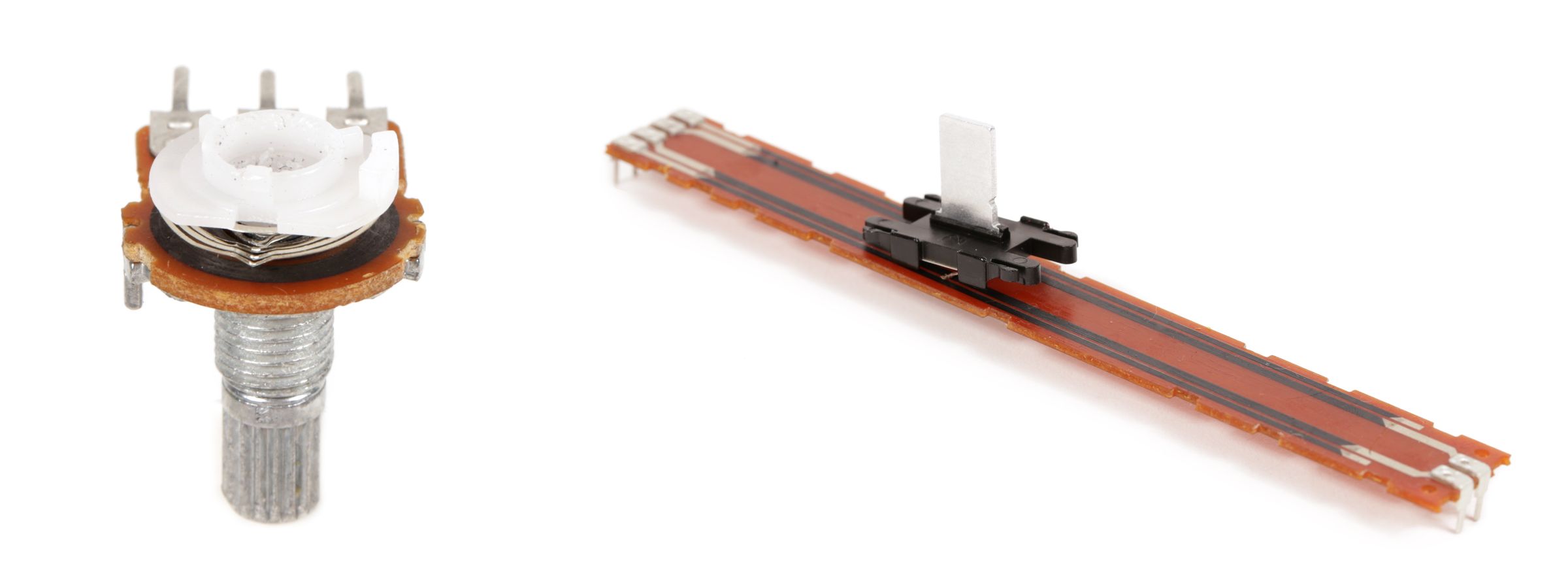

The inside of a potentiometer does not look remarkably different from our paper resistor. In fact, it is basically just a miniaturized version of what we have made. Instead of moving a paperclip, there is an actuator knob or sliding lever that moves a conductive element over an electrically resistive surface.
By connecting a wire to either one of its outer terminals, and another to the center terminal, we can wire a potentiometer as a variable resistor.

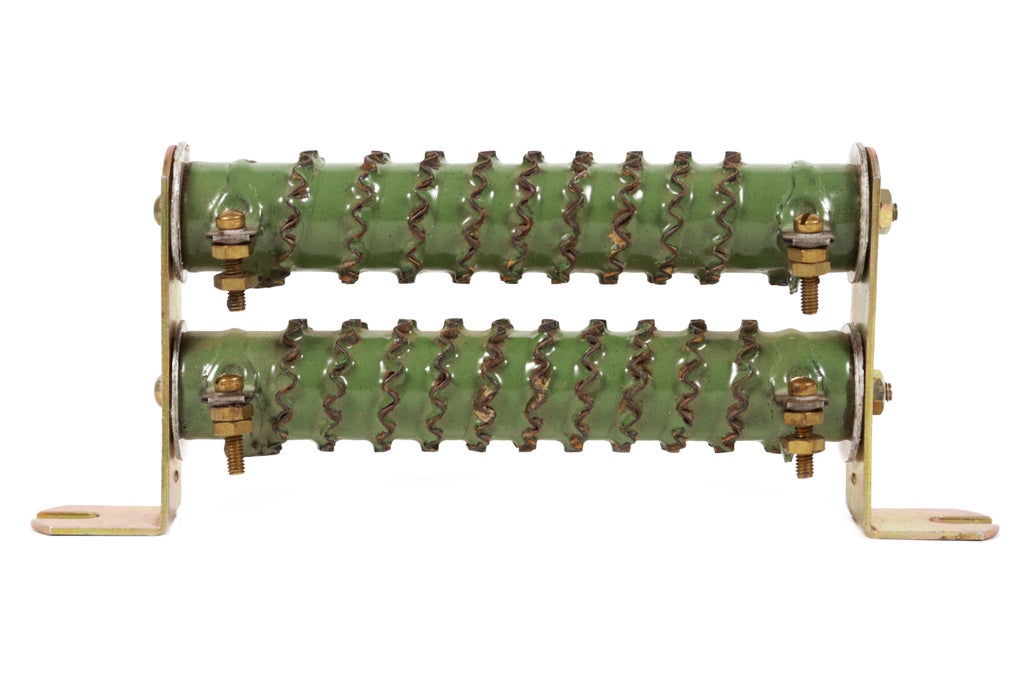

These two gnarly looking metal tubes are actually giant resistors used as voltage dividers for converting the electrical system in a military jeep from 24V to 12V. While crudely effective, it is by no means the best way to do this. Resistors work by converting energy to heat, which is a wildly inefficient way to solve the problem of voltage conversion. Additionally, unlike the massive resistors pictured above, standard resistors are not rated to handle the current that a typical circuit requires. Trying to power electronics through a voltage divider will in all likelihood release the 'magic smoke' from one component or another.

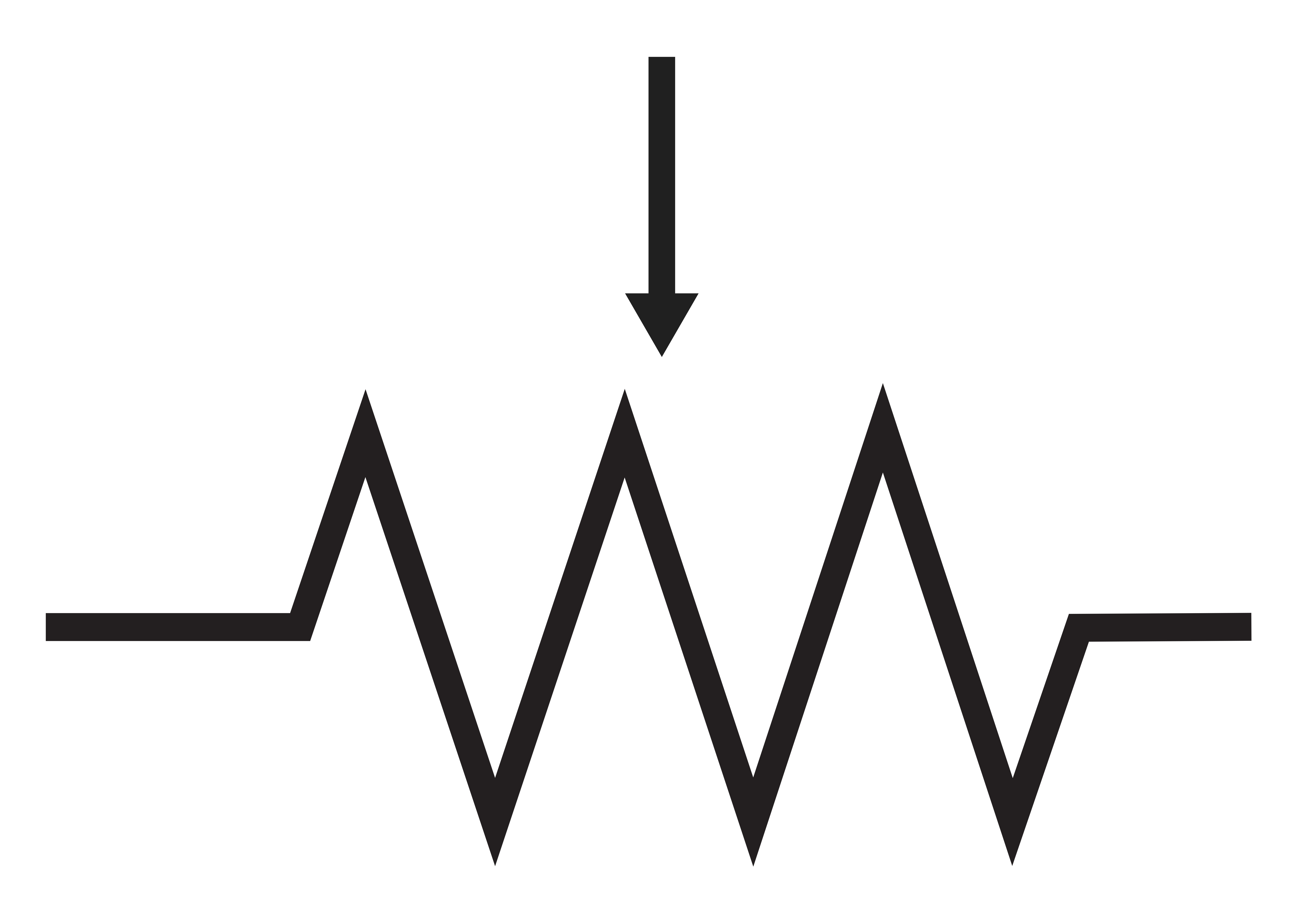

In a schematic, a potentiometer looks like a resistor with an arrow pointing towards the center.
