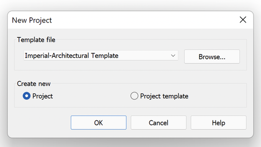

Step 3: Revit
Open a blank Revit architectural template. I prefer imperial units so I opened an imperial architectural template.

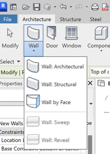

Step 6: Interior Walls, Doors, and Windows
  1. Create the interior walls
  2. Go to the "Architecture" Ribbon and click "Wall: Architectural"
  3. Click "Generic 5""
  4. Click "Edit type"
  5. Click "Duplicate"
  6. Rename
  7. Alter as desired
  8. Press "Apply" and then "OK"
  9. Place the walls along the edges of the container. Change the "Location line" settings as needed.

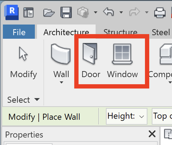

  10. Place doors and windows. Load in the desired sizes and styles. Because we have two walls I placed the doors on the exterior walls and then created openings using the wall opening tool.

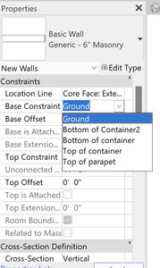

Step 8: Foundations and Steps
This does not necessarily have to be done in this order and would probably best be done last or first depending on whether you are building this on or off-site. I intend that the container would be lifted up using CMU blocks to prevent water and moisture damage.
Creating foundation:
  1. Add new elevations we missed earlier. Reference image.
  2. Open Site plan.
  3. Select Wall: Architectural, selected desired wall type.
  4. Change bottom and top constraints as shown in the image.
  5. Place base supports.
