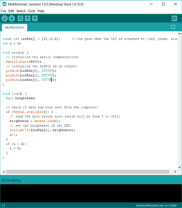

Step 3: Program the Arduino
Below I’ve attached the program file for the Arduino. It’s ready to load on the Arduino, just open up the file in the Arduino programming software and press upload.
This program listens for a brightness value for each color from the computer. When it receives the value, it sets the brightness by “writing” the brightness value to the correct pin.
One thing to note is the array named ledPin[] at the beginning of the program: this defines the Red, Green, and Blue pins on the Arduino. If the LEDs are showing the wrong colors, make sure they are connected to the correct pins.
