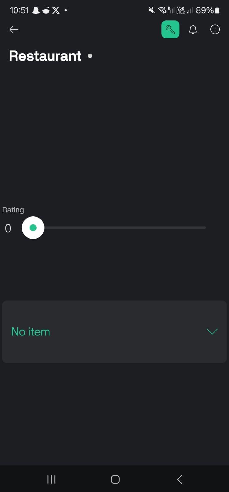

Step 4: Configuring and Customizing the Blynk App
1.Create the Dashboard
  1. In the Blynk app, create a new project and configure the widgets by assigning the virtual pins used:
  2. V0 for the “Order Ready” state.
  3. V1 for service rating.
  4. V2 for event notifications (cleaning or manager call).
  5. V3 and V4 to display temperature and humidity.
  6. V5 for reset signaling.
  7. V6 for menu selection.
  8. V7 for the distance measured by the proximity sensor.

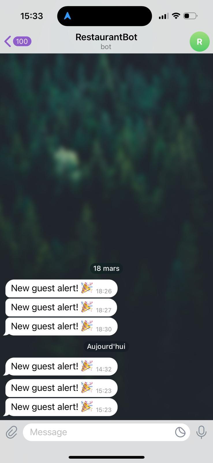

Step 5: Integration With Make.com for Automation
To further enhance the system, we have integrated Make.com to automate the handling of proximity sensor events:
Event Trigger
When the proximity sensor detects a customer entering the restaurant (i.e., when the measured distance is below a certain threshold), the ESP32 sends an HTTP GET request to a Make.com webhook.
Make.com Automation:
The webhook triggers a scenario in Make.com that:
Logs the Event:
Records the event in a Google Sheet with the current timestamp, a message stating "new client arrived", and the exact date and hour of entry.
Sends a Telegram Notification:
Immediately sends a Telegram message to the restaurant, stating "a new client arrived at the restaurant".
This automation ensures that every client entry is documented and that the restaurant is notified in real time.

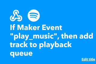

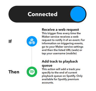

Step 6: Webhook Integration With IFTTT for Spotify Automation
To automate music playback, we have integrated IFTTT with a webhook trigger:
Event Trigger
When an external system (e.g., a script or smart device) wants to add a song to the Spotify queue, it sends an HTTP GET request to an IFTTT webhook.
IFTTT Automation:
The webhook triggers an IFTTT scenario that:
• Adds a Track to the Spotify Queue:
The specified song is automatically queued in the current Spotify session.
• Ensures Seamless Playback:
The system enables real-time music selection without manual intervention, ideal for smart home or automated DJ setups.
This integration allows dynamic control over music playback based on external triggers.
