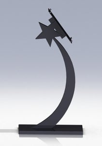

Introduction: Restaurant Pedestal Sign, or How to Make Simple 3D Extruded Shapes.
So this is a pedestal sign I made for a restaurant using their logo as the profile.
This method is a really easy way to get nice looking 3D extruded profiles.
The sign features interchangeable acrylic plaques with things like "Please wait to be seated" and stuff like that.

I made a model in 3D for the laser cutting profiles and to get a cut list for the other parts.

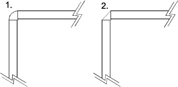

Step 1: The Base
The base was a simple construction a frame of 25mm X 25mm SHS (Square Hollow Section)
The top was a piece of 6mm steel plate.
The plate was cut about 10mm smaller around to allow for a weld and a bevel
This lets you do a fillet weld around the plate and frame, leaving enough weld to grind flat, leaving a nice
beveled edge. (See Weld detail below)
1. Fillet weld 2. Weld ground down to bevel, leaving sufficient weld to hold.
1. Not enough space for fillet weld. 2. Grinding down leaves little to no weld holding the two together.

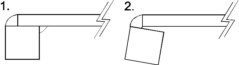

I also did a few 50ish mm long fillet welds on the insides first before I fully welded the inside.
Total overkill really but I wanted to make sure this thing sat dead flat. A few tack welds would be enough
The problem with welding on one side only is you're likely to pull the SHS around.
One side gets hot then contracts pulling the SHS, see Detail 2.
1. Welded both sides, SHS stays flat. 2. Welded outside only SHS pulls around on it's corner (exaggerated)
Having said all that we aren't building a spaceship, this thing just sits there, so getting these weld details exactly right isn't necessary.
It's a good thing to keep in mind though when welding/finishing, coming from a boiler/structural apprenticeship
this is just habit now for me to do these thing this way.

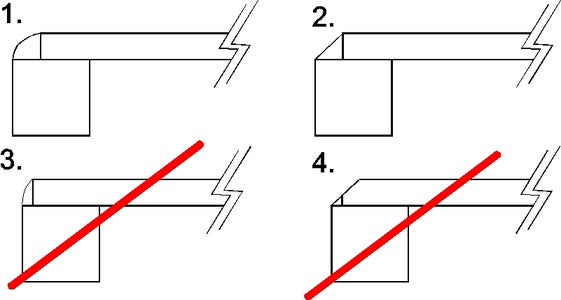

Now it was time to fill the sides in. Using the strips I had laser cut I proceeded to tack weld them along the shape of the profile,
using clamps to hold the parts down to the shape.
You want to pay particular attention to the alignment at this stage. If the two edges are to far out of alignment once you go to grind the top of the weld off to produce a bevel it will be uneven along the edges.
You also run the risk of grinding off too much of the weld or the sheet metal creating a weak join.
See welding detail below.
1. Pre ground weld, leave a small gap to allow weld to properly penetrate.
Once you have all the sides on you're ready to weld.

I weld small runs of weld alternating positions along the edge and also between sides.
This keeps the heat to a minimum at any one spot which stops the sheet metal distorting.
It's probably less of an issue with mild steel, aluminium and stainless are a lot worse for distortion.
Referring to the weld detail again 1. You want to try and keep the weld between the two outer edges of the steel.
If you can follow this all the way when you grind the bevel it will be perfect all the way along.

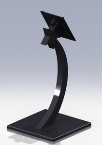

Step 7: Plaque Holder/Bases
This piece I made in Aluminium, using the same welding/grinding technique to get a nice bevel on the edges.
I used 25mm X 50mm RHS and TIG welded some pieces to blank off the ends.
This piece bolts into a notch in the top of the star, the plaque holder is riveted and glued to this.
I used bolts to connect this piece because I didn't want to weld the star. I wanted i to look like
the star was just snugly holding the piece in place.
