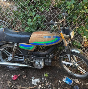

Anyway, I saw this old moped for sale locally for $100, and I couldn't pass it up. I actually gave the seller $150 since he delivered it.
It didn't run. And it was very rusty. So here we are...

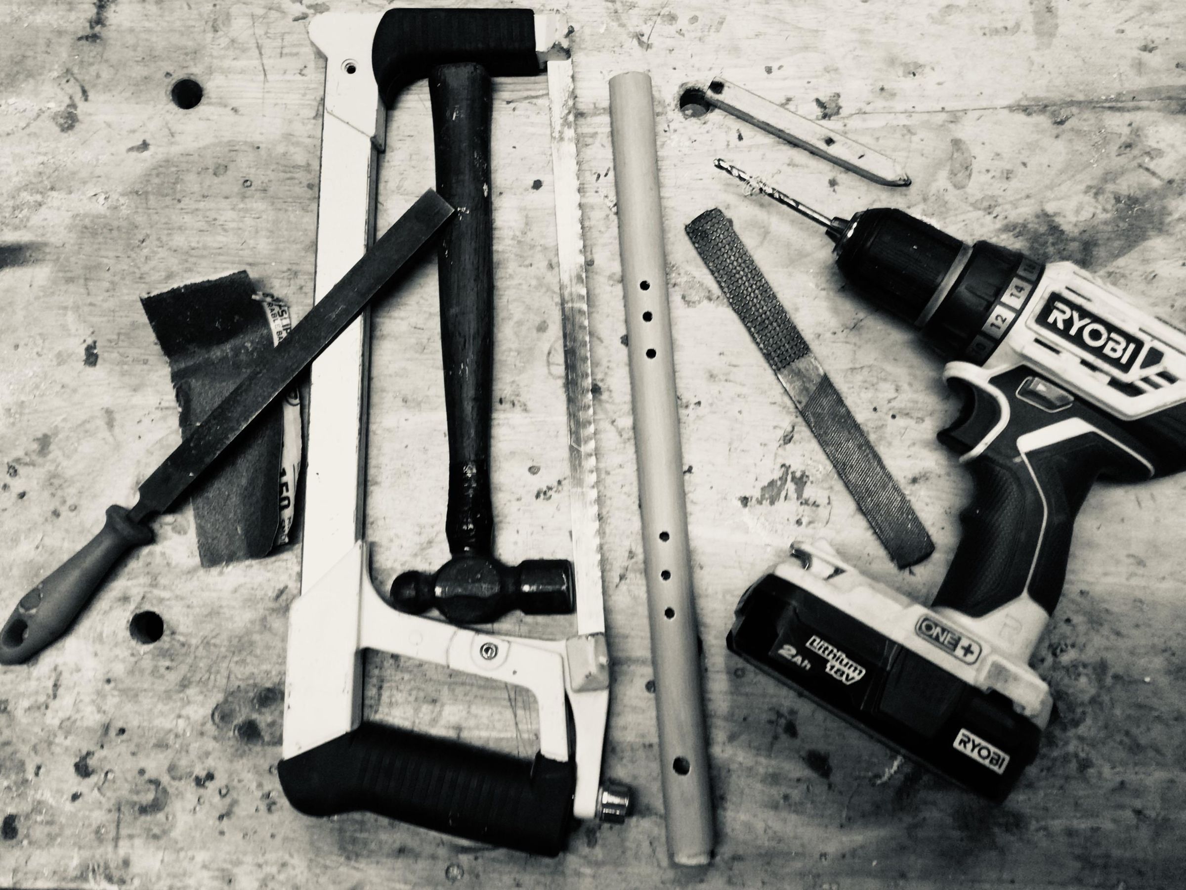

Tools:
  1. All the regular household tools
  2. I used an angle grinder with a wire brush on the rusty parts.
  3. you might need a power drill.
Of course, what tools you need will depend on your situation. That^^ is what I used. Depending on the bike you might even need a welder.

Step 2: Tearing Down the Bike
The extent to which this is necessary will vary based on the condition of your bike.
So if your bike is super rust like mine, you wanna just take off what you gotta take off. I took off the seat, side cover, rack, and handlebars. These will get repainted. Well ok, not the seat. That would be weird, painting a seat? who does that? Oh wait, I did that one time.
Anyway, moving on.
If you encounter any stuck screws, try using an impact driver (the kind you hit with a hammer). It's such a worth it tool to have.
Wait!! Before you start!! Take some pictures first!! This will make it way easier to re-assemble.

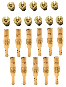

The moped is slow; it maybe goes 30 mph with a tailwind. Let's fix that.
A good pipe and bigger carb is usually a good place to start. So I put on a people's pipe and Dellorto 15.15.
Important: Your carb will NEED to be re-jetted after you change the carb or pipe. Buy a good range of jets. Start by checking what jet your carb has already.
REMEMBER: Smaller jet number means leaner. Larger means richer. See the picture for tuning.
In order for the carb to clamp to the intake I needed to shim it. I used a milk jug.
After doing this, the moped is noticeably faster and has better acceleration.
