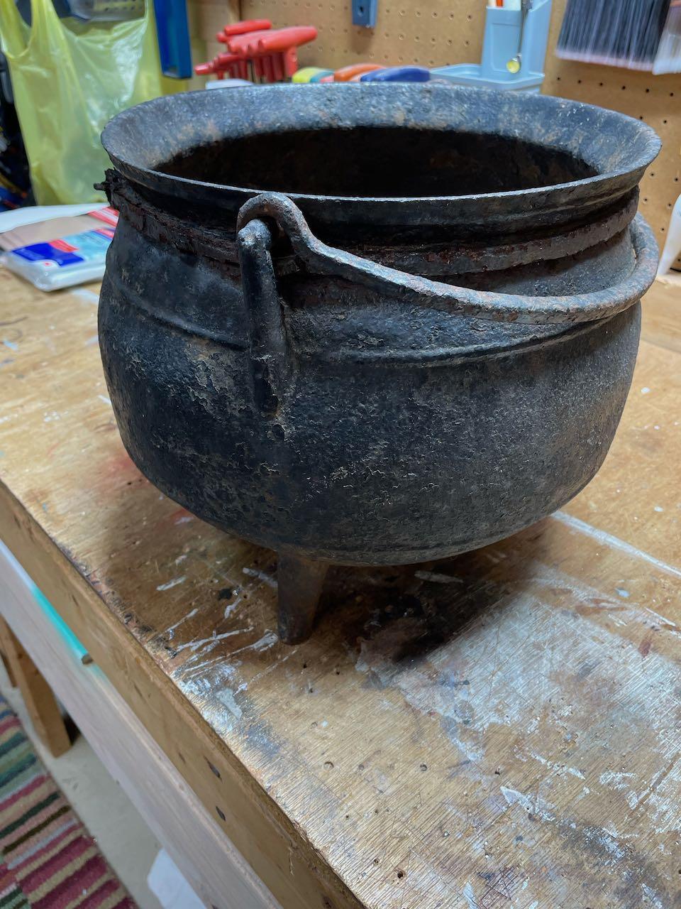

My wife's great-grandfather owned this old cast iron cauldron/pot that was used for many years as a plat holder. Over the years, it cracked and the bottom completely rusted & rotted away. Instead of throwing away this family heirloom, I decided to use some fiberglass resin and a fresh coat of paint to restore this item and use it in our backyard.

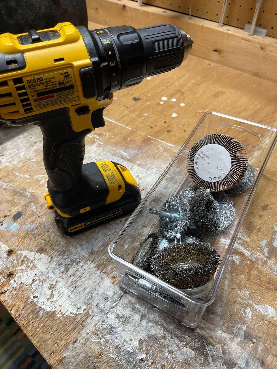

These wire brush drill attachments help to remove the old rust & scale
I'm a fan of the Dewalt cordless tools - I used the Dewalt cordless drill
I also used a screwdriver to chip off some of the toughest scale

As you can see by the photos, this pot was pretty destroyed from age & rust.
I used a screwdriver to chip away some of the toughest scale & rust.
I then used wire brushes on a cordless drill to clean all of the old loose paint and rust from this pot.
