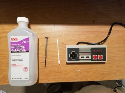

Items needed:
NES controller
Rubbing alcohol
Q-tips
Philips screwdriver

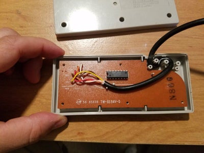

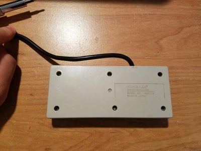

Open the controller by using the Philips screwdriver on the 6 screws on the rear of the controller.
Use the Qtips and alcohol to clean the gold metal contacts very thoroughly. You will be surprised at how much grime will come off.
The rubber membranes under the keypad and actual buttons should be VERY gently rubbed to get the dirt off. These tear easily so be careful.
The keypad and buttons get the brunt of the dirt, and they are most easily cleaned by actually just leaving them to soak in a some rubbing alcohol. A few minutes is enough, and they will usually be sparkling after. A Qtip can be used for detailing but is usually not necessary.
