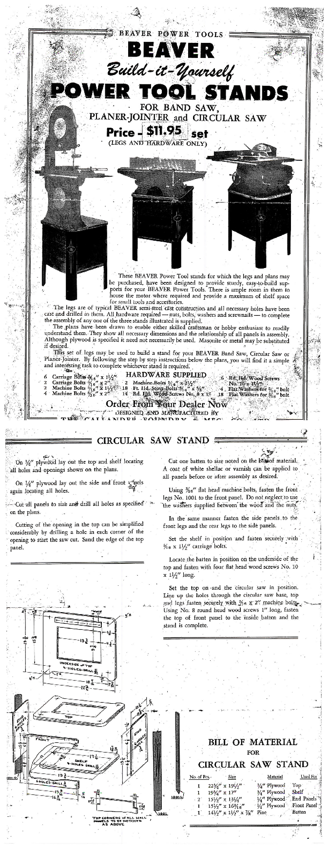

The body of the saw and the legs are not meant to be a pair. The legs were made by Beaver around 1953 ( the year beaver was bought by Rockwell).
Vintagemachinery.org actually had the instruction manual for the legs so I was able to use it as a reference. A little more on this later as I forgot that the saw and legs were not made for each other....

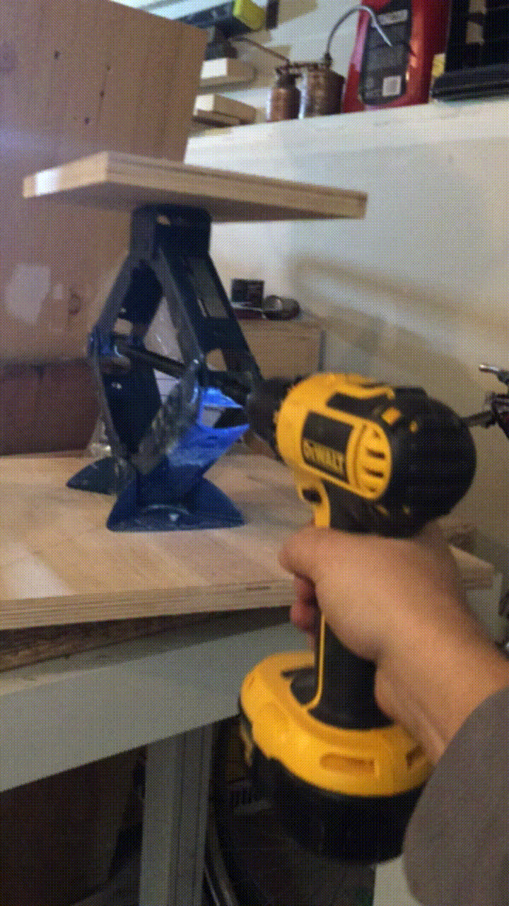

Step 14: Ooooo Lifty!
Ooooooo lifty. This is a scissor jack with a couple boards screwed to it. It will get mounted under the inner shelf of the saw and have casters mounted to the bottom. It will push the casters into the ground, thus raising the legs off the ground and I'll be able to move the saw around easier. and I don't have to worry about losing traction when I'm sawing because the saw won't be sitting on the casters, but it'll have 4 legs on the ground. It is pretty handy that I can use my drill to make it go up and down instead of hand cranking it.
Here is the completed lifting mechanism. Nearly completed, I should say. I added some steel rods to keep it on track when lifting and lowering.

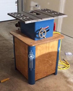

Step 24: Glamour Shot
This was a hell of a process but I love how everything cam out. Thanks for having a look!
