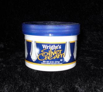

I use Wrights Silver Cream for my polishing. There are several other quality brands out there but I've never used them. You should follow the directions on your product instead of following what I say in their use.
