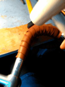

Step 3: Handle Bar
For this you'll need long strips of leather.
Again, I soaked them in hot water for 15 minutes, and started to stretch the strips around the handle bar.
The leather that I used was quite thick, so I had to flatten it using wooden hammer.
After a day when the leather was dry, I glued the leather strips to the handle bar.
