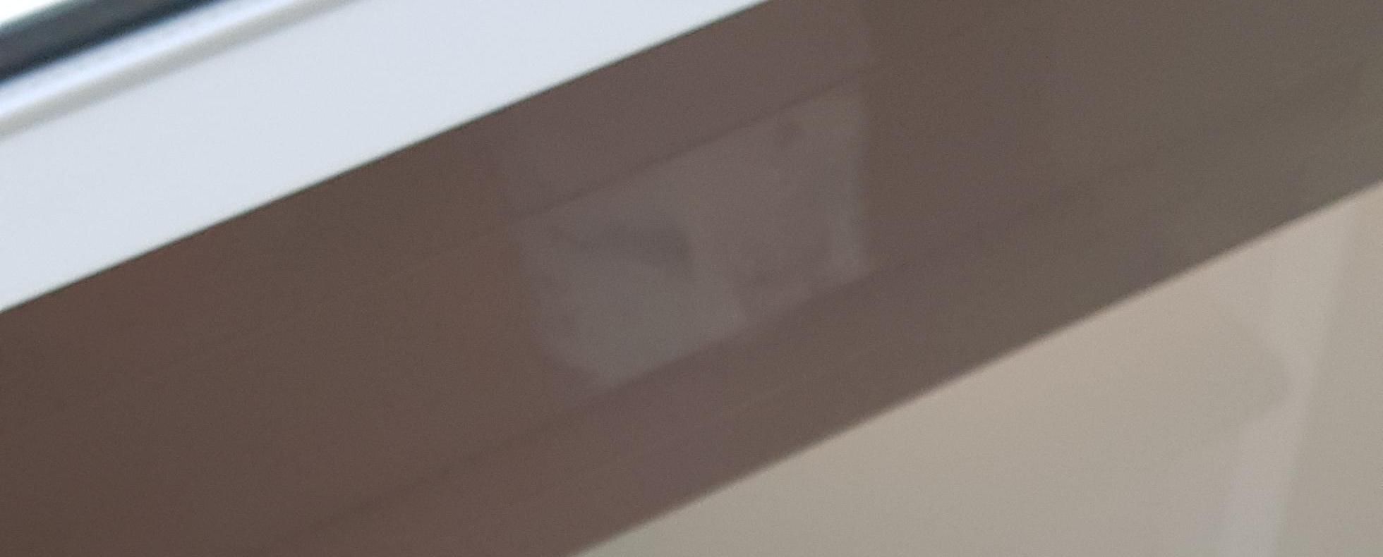

I cleaned from ink and letters the panel of the washing machine. I simply rubbed it with a cloth to remove all the lettering.
Step 5: Put the Tape on the Appliance
I placed the tape (sticky side down) over the buttons and, after finding the right position, cut the residual tape and stuck it firmly.
As you can see, I used two strips of paper/tape, one for the line of lights and another for the line of buttons.
