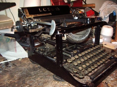

The first thing I tackled was the space bar issue.  If you look closely at photo 1 you will notice that the space bar is not sitting level -- it is higher on one side than the other.
Turning the typewriter on its back (photo 2) I found the problem, actually two problems.  First, a screw was missing that attached the space bar to the space bar lever (noted in photo 2).  Also, the stops on the space bar had been bent downward, probably from someone pulling up on them because of the problem with the carriage hanging up.  I bent them back into position using my needle nose pliers, replaced the screw, and all was well once again in space bar land!

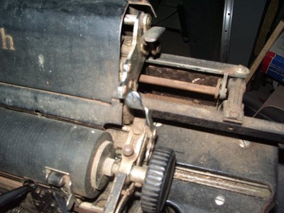

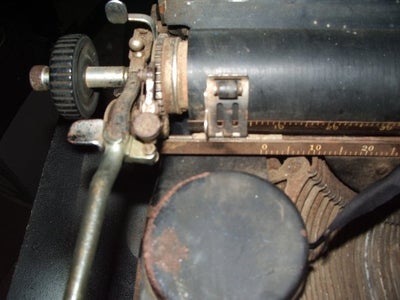

The cause for the carriage hanging took a bit more time.  What I found was at the back of the carriage, the tab bar needed to be adjusted.  Someone probably leaned this old machine on its back without supporting the weight properly, causing the tab bar to move inward slightly.  I slightly loosened the tab bar's screws on both sides (see photos), lightly tapped the bar back into alignment with a brass hammer, and tightened the screws.  This fixed the "carriage hang" problem.  But, the carriage still squeaked when it moved, which is addressed in the next step.
Step 4: Fixing a Squeaky Carriage
The cause of the squeak was dryness and filth!  I taped an alcohol-soaked cotton swab onto a bamboo skewer, and cleaned the track shown in the photo.  Once I had 74 years of debris cleaned out, I lightly oiled this track with a cotton swab.  The squeak was gone, and the carriage moved like new.

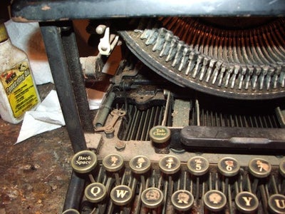

Step 6: Cleaning the Inside of the Beast

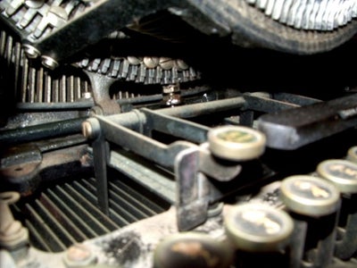

With the mechanical issues behind me, I started on the lengthy process of cleaning this beast.  With all the panels removed, I began by blowing everything out with compressed air.  This removed the cobwebs, but not the 74 years of caked on dust, dirt, and tobacco residue (pretty much every office in the '30's, '40's, and '50's was filled with tobacco smoke).
This is where the acetone, alcohol, and q-tips came in.  Using q-tips and cleaners, I cleaned every surface possible inside this machine.  The first three photos show the condition before I began, and the last photo shows the improvement inside the machine.  This was a lengthy process -- I worked on this off and on for almost a week, but when I was finished, 74 years of accumulated dirt and grime were gone!

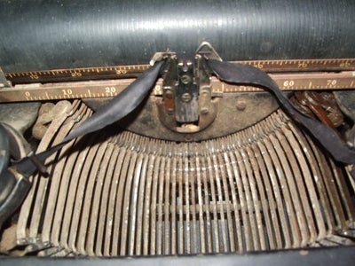

Cleaning the type bars on these old machines is tedious.  Using q-tips and alcohol, I scrubbed both sides (and the tops) of each individual type bar -- one at a time!  Photo 1 shows what they looked like before I started, and photo 2 shows the results.

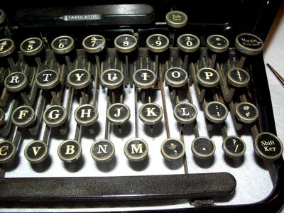

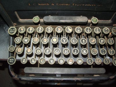

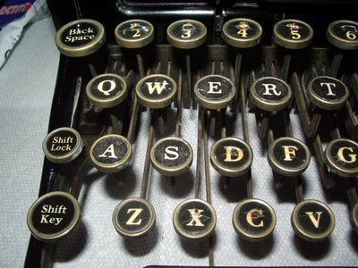

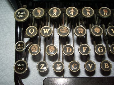

Step 10: Replacing Bad Key Tops
There were 9 keys on this machine that had key tops that were literally worn out (see first three photos).
Using a special font on my computer, I printed new key tops on a piece of off-white paper, and laminated both sides with a cold laminating film.  The film on the top side is designed to mimic the original finish of the key tops, and the film on the back side keeps my glue from discoloring the new key top.
I cut these out and glued them onto the old key tops (see the last two photos).

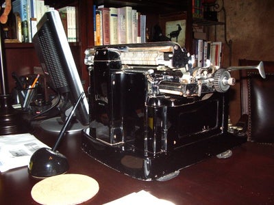

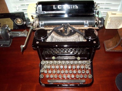

Step 11: Completed!
I didn't keep track of how much time I put into this old typewriter, but I'm guessing it was somewhere around 30-40 hours.  I don't really count this time as labor, however, because I enjoy bringing these old machines back to life.
Most people would probably have considered this typewriter beyond help due to the condition I found it in.  The secret to bringing something like this back from the dead is not to be overwhelmed at everything that is wrong, but to tackle each problem one-at-a-time and fix it.  If you stay with it, eventually you have success.
