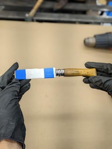

Step 2: Preparing the Knife
I cut a strip of cardboard to wrap around the blade to protect against accidents and then wrapped masking tape around the cardboard to hold that in place!
I suggest masking the locking mechanism so that during the sanding process, so it doesn't get scratched.
(I didn't think about masking it and lightly scratched the surface)

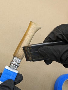

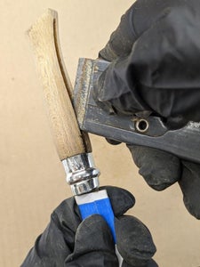

Step 3: Stripping the Knife Handle
Its time to strip the handle!
Unfortunately I had to remove the "Opinel" logo in the process of stripping and sanding the handle to make sure everything was smooth, but it still has the "Opinel" stamp on the blade so I wasn't too worried about that.
I used a heat gun moving back and forth across the handle until the varnish begin to bubble, and then began to scrape the handle down to the bare wood.
You really don't need to hold the heat gun on it long and even if it doesn't quite bubble but only gets warm, it makes the scraping a lot easier.

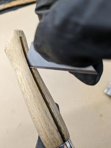

I found that using a normal razor blade works quite well to fit inside the slot in the handle to make sure it gets fully scraped too.

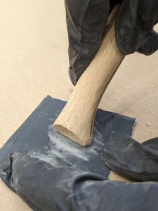

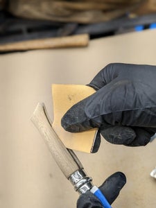

Step 4: Sanding the Handle
Sanding the handle is a pretty straightforward process, only involving a little time and feel.
I started with 180 grit as the handle was pretty smooth to start and gradually worked up to 400.
Folding the sandpaper helps to thicken it up so that sanding in the gap is easier!
