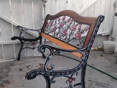

I recently found an old an old rotten out patio/ garden bench thrown out from somebody's home and i decided to pick it up and try to restore it, the reason i did so was that , it had a flower design unlike most patio benches i have seen. I will describe as much as i can how i restored this bench in the next steps

For the whole frame. Sand and clean the frame to take off any debris and spray with black rustoleum paint.
then for the raised edges with a brush , apply a white paint.
For the back flower pattern apply red for the roses and green for the branches and leaves with a brush of course.
then for the heightened places on the rose and leaves and branches apply a lighter shade of the green or red.
