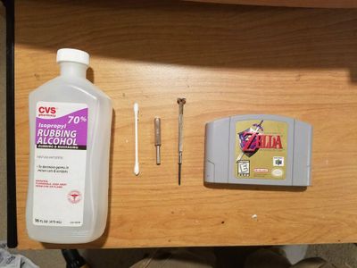

Items needed:
N64 cart
Rubbing alcohol
Q-tips
(Optional for really dirty carts: Bar Keepers Friend and an old toothbrush).
Small Nintendo bit (there are 2 sizes, they can be bought on ebay for about $3).
Philips screwdriver
If you are replacing the battery, you will also need a soldering iron and a new battery CR2025 or CR2032.

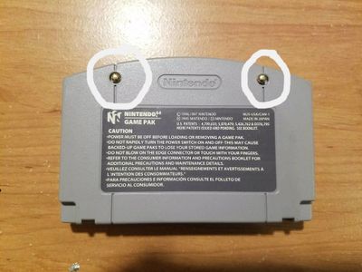

Open the cartridge by using the Nintendo bit on the 2 screws on the rear of the cartridge.

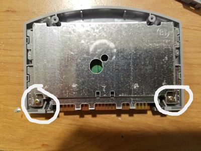

Use the philips screwdriver to take off the 2 screws holding down the metal cart shield.
Slide off the contact sealer (the little plastic doohickey which fits around the contacts).
Use the Qtips and alcohol to clean the gold metal contacts very thoroughly.
You will be surprised at how much grime will come off. After that, you can reseal the game as it was before and it should work way better.

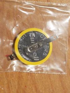

If your game no longer saves, the battery needs to be replaced. Remember , these babies are 20+ years old.
There are 2 methods for replacing battery, both of which assume you have just the most basic soldering skill.
Make sure the positive side of the battery of face up.
Method 1) Desolder the batter from its holder and replace it with a new one, leaving the old battery holder in place. This method is easier, but usually is not a great connection.
Method 2) Remove the entire battery and holder and replace with a fresh battery that came with a built in holder. These can be found on ebay for about $1 each, and this is a greater connection. Good luck!
