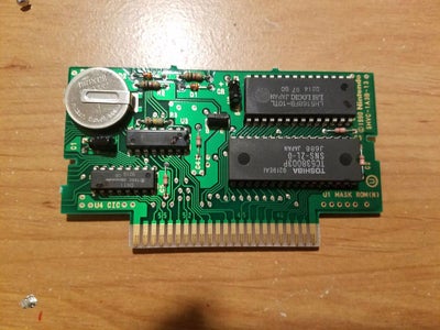

Open the cartridge by using the Nintendo bit on the 2 screws on the front of the cartridge. Interestingly, all Nintendo games across all consoles have the screws on the rear of their carts, except for SNES. Weird.
Use the Qtips and alcohol to clean the gold metal contacts very thoroughly. You will be surprised at how much grime will come off.
After that, you can reseal the game as it was before and it should work way better.

If your game no longer saves, it is typically a battery problem. The next step is optional for replacing the battery.

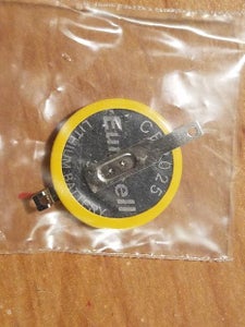

If your game no longer saves, the battery needs to be replaced. Remember , these babies are 20+ years old.
There are 2 methods for replacing battery, both of which assume you have just the most basic soldering skill.
Make sure the positive side of the battery of face up.
Method 1) Desolder the batter from its holder and replace it with a new one, leaving the old battery holder in place. This method is easier, but usually is not a great connection.
Method 2) Remove the entire battery and holder and replace with a fresh battery that came with a built in holder. These can be found on ebay for about $1 each, and this is a greater connection. Good luck!
