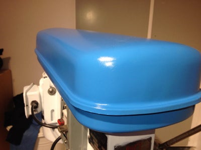

Step 7: Painting
When painting it is important to make sure the surface is as clean as possible. Depending on the way the old paint was removed, you might have small amounts of oil and grease on the surface. You will not be able to see this with the eye, just make sure every part is wiped clean before you begin painting. This also removes dust particles.
For those of you who don't know, a primer is a layer that makes the paint stick better, you can think of it as glue. I use a spray can primer made for metal only. Spray cans and paint guns will give a better finish than using a brush. I think using a brush, gives access to choose some heavy duty metal paint, but I'm not sure. However, I'm just gonna use spray cans for this project.
I painted most of the parts on a piece of cardboard, but this meant I had to turn the parts around, in order to paint the other side. Instead, I finally began hanging the parts up. I just used some steel wire to hang the parts. On the blue part of the pulley housing, I didn't have a good place to wrap the wire around, so I used a bottle cap bigger than one of the holes in the pulley housing, instead of having a little wire wrapped around half of the part.
When painting, it is important that you don't make a puddle a paint in one spot, since it looks really bad. Increase the painting distance and spray in light layers in order to avoid this. Another thing to remember is light, it's very important to have good lighting when painting, otherwise, you might just end up with some under painted spots (like me). When painting and using a uv something something clearcoat it is very important to wear a proper respirator. I used a dust mask since I didn't have one, but I ended up having a headache afterward, even though I was VERY careful not to breathe any. Not worth it, just get a respirator.
- Spray in smooth motions
- Use correct spray distance (can be found on the spray can)
- Spray in light layers
- Paint in lighted area
- Use a respirator

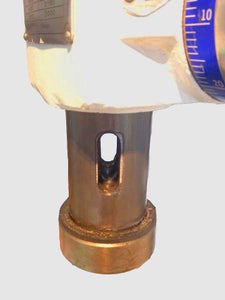

After painting, it is a good idea to apply a layer of clearcoat to seal the surface 100% and protect the paint.
I ended up using a little under two 500 ml spray cans of primer.
Step 8: Assembly
Assembling the machine should be easy since you took a lot of pictures, right? In this step, I will therefore only cover how not to press fit a pulley, and the wiring of the electronics (and include pictures of the motor assembly, as can be seen above, obviously).
Press fitting a pulley
When you need to press fit a pulley, you cannot use a hammer with a small tip surface on cast aluminum. I have tried, and yes, it will break. I was very careful with not hammering on side of the pulley, and I used four layers of cardboard to hammer on, in order to distribute the load, but it didn't end up so well. Instead, use a rubber mallet and a hard flat piece of material to distribute the load while hammering.

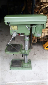

This is extremely timely! I got an (almost) identical press (Same color, only 2 pulleys, no identifying marks, depth guage) at a garage sale for $30, and I'm in the process of tearing it down! Thanks alot?
Reply 5 years ago
I inherited an old General Machinery (I think) that looks almost identical to this one but it's certainly looks only. It's sold by Harbor Freight for under $100 new. Same green color, size and appearance.
