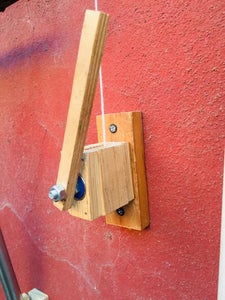

Step 2: Building the Bottom Mechanism.
To make the mechanism located in the down, I used a couple of simple machines, a wheel and axle with a screw. For this, we need a couple of bearings, one bolt and 4 nuts. In the first picture you can see the order to assembly,but dont assembly yet! before place a couple of block mount between bearings (the greatest diameter must be outside). Why using a threaded bolt? this because we are using the property of screw to fix the rope, and, get the capacity to move when we rotate the screw, convertir the circular motion to a linear one. Of course try to rotate the bolt with the hand could be a little bit harder, for solve that, we are using another simple machine, the lever. We can pick any stick for that job, just need only a little hole in the extreme to fit into the principal bolt. To fixed all the parts, just add a couple of supports between the block mounts,just like the last image of this section suggest.

Step 8: Placing the Simple Machines.
Now we just have to place the mechanisms on the wall, start first with the lower mechanism. A couple of screws and anchors are enough.
Do the same with the upper mechanism, this is the crucial part of the assembly, as this is where you need to make sure that the rope is taut, and the rope ties on the screws are in the correct places. Once you have decided where the rope is taut, screw the upper mechanism to the wall.
Here you get a reward, turn the lever to see what happens ...

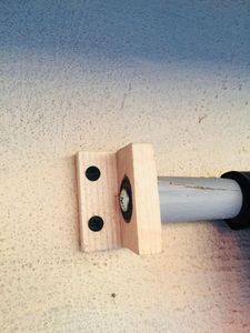

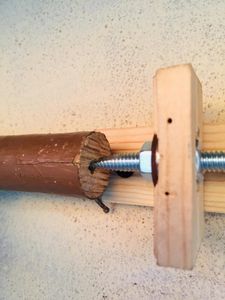

Step 9: Placing the Shaft.
The part that you decide to put the main roller on the side of the upper mechanism, you must make a flat hole, this you do with the help of a wide flat screwdriver, just as in the first image of the section indicates. At the other end, we will place a bearing to allow freedom of movement. For this we use an wood block mount, a nut, the previously mentioned bearing and a screw. Place them in the order illustrated in the second image shown. Once assembled, nail a bracket the same size as the block mount. Dont fix it yet! first you must to couple the shaft to the flat spike in the top mechanism, when matched, you can fix it on the wall.

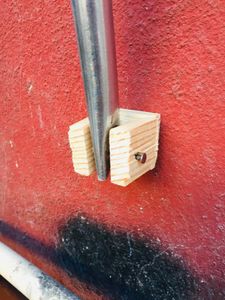

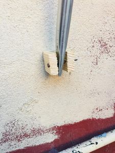

Step 10: Placing the Tent Supports.
This also, is another easy part of this instructable, just make little supports with wood, ensure to drilled the holes before join the parts supports,in that holes must be a pin through (nail) to fix the tube tent support,.With a screw and anchor, place both support in the wall. Now the tent support Is fixed to the wall, the other extreme must be screwed to the extreme of the table "stapled" in the plastic bag.

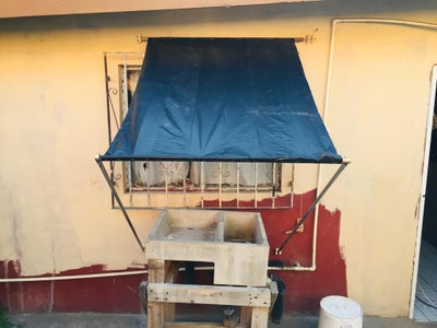

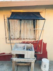

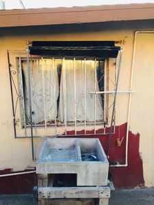

Step 11: Final View, Tips and Recommendations.
Finally finished! here is a way (of thousands) to do a simple tent with cheaper components, of course, this can be better, they are many ways to do the same task, we just need to look around and search for correct components, this is the philosophy that I follow every day with all the tasks that I face in everyday life.
