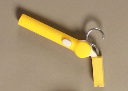

Step 3: Making the First Connection
What you'll need:
  • Swiffer joint
  • The hook
  • One magnet
  • Approximately 6cm of the aluminium profile
  • F16 resin
  • Pigment if preferred
  • Mold release wax
  • Wooden plate for the mold surface
  • Tape
  • Glue
Glue the hook to the outside of the white part of the Swiffer joint with the head against the joint itself. This doesn't need to be too secure because it will later be embedded in the F16 resin.
To make the mold, stick the magnet to the wooden surface with a little piece of tape. Then take the aluminium profile, rub the inside with mold release wax and place it around the magnet. To secure the profile, tape it to the wooden surface and use some plastiline to secure it even more if needed. If there are any holes, the resin will flow out of the mold. Now place the white part of the Swiffer joint in the profile.
Take a small amount of both the F16 components. If you would like to colour it, put in one drop of the pigment in the white F16 component and stir. When stirred properly, mix the two components and stir again. When the resin is mixed properly, pour it in the mold very carefully. It will harden in 5 to 15 minutes. Because of the wax it should be easy to remove the part from the profile.

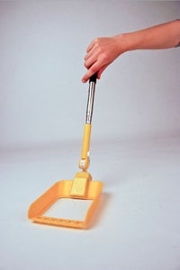

Step 7: Finished Product
You now have a retractable poopshovel with additional hook and magnet that takes very little place when folded. Place a waste bag trough the hole in the shovel and fold it over the edges. The shovel is also easy to take off if you only need the hook or magnet.
