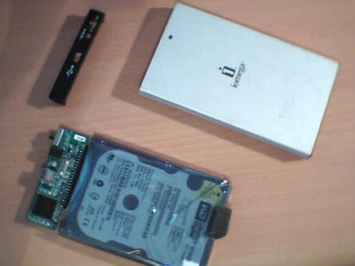

Step 1: Disassembly
The name says it all.
I am using a 60GB iomega portable usb powered HDD. this is good because it uses a Laptop HDD and i want to get files from a laptop. I you are trying to get file off a PC then you will need a different external disk.
Once you have removed the dick from its enclosure gently disconnect the PCB. This is the bit that controls the drive and connects to a usb port..

Step 3: Conect Up
Very simple.
Plug the PCB into the new drive. Be careful not to bent any of the pins of flex the board too much, it was never designed for this kind of abuse.
Step 4: It Works!
Or not.
Plug it into a computer via usb and it should appear as a removable storage device.
