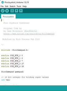

Step 1: Programming the Pico
Code is based on Real Robots video here:
https://youtu.be/CNF7G-1LniI
Basic Steps as outlined in the video:
In the Arduino IDE, go to Boards Manager and search for Pico.
Find and install: “Arduino Mbed OS RP2040 Boards”
Get the library from : https://gitlab.com/realrobots/PicoGamepad
Download the ZIP file, extract and rename the folder to PicoGamepad (remove the “–master”)
Copy the folder to Documents > Arduino > Libraries
Restart Arduino
Load the modified code and upload to the Pico. I found the Adruino IDE sometimes would not see the Pico to upload and would get a serial port busy error. The solution I found was to simply reboot the PC.

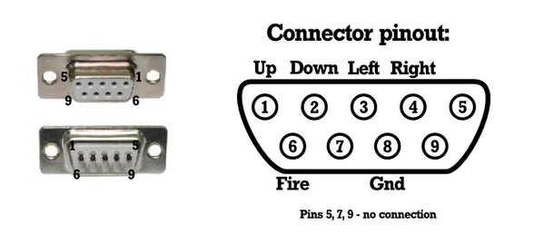

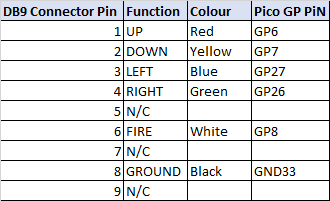

Step 2: Connect the 9 Pin Connector to the Pico
Solder a short (roughly 5cm) wire to pins 1,2,3,4,6 and 8 on the DB9 connector as shown in the diagrams.
Solder the other end of the wires to the GP pins GP6, GP7, GP27, GP26, GP8, and GND33 on the Pico.
I picked GP Pins on the Pico roughly in the middle of the board so as to not get in the way at either end. If you want to pick different pins alter the program accordingly in the define section.
Test the Joystick on the PC by opening the "Game Controllers" control panel, if all is well and the board is programmed correctly, you should see "PicoGamepad" listed. Select Properties and test the directions and fire. The LED onboard should flash with the fire button.
