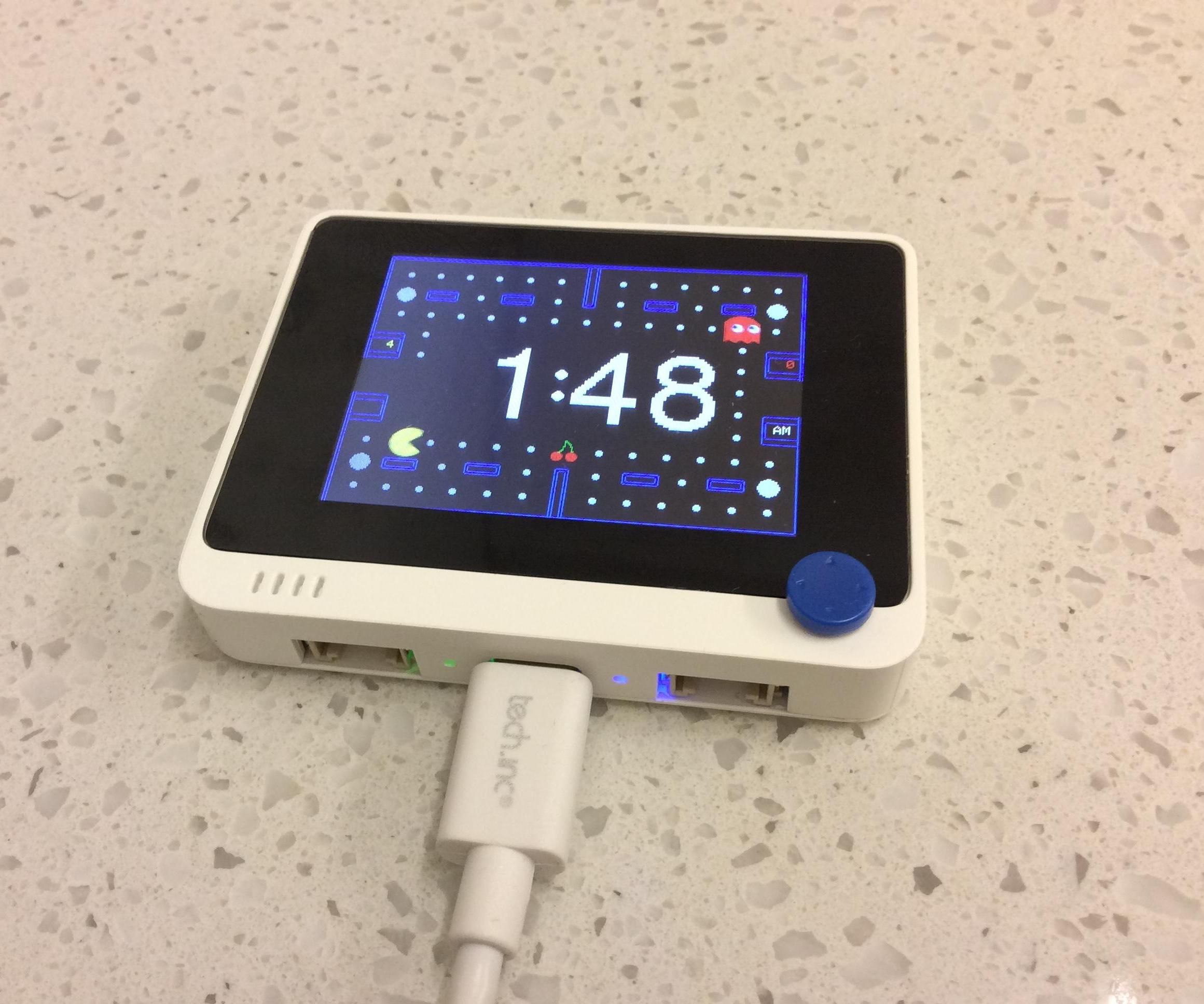

Introduction: Retro Arcade Clock - Arduino
Build an interactive arcade bedside clock, with a touchscreen, and animated arcade figures that you can record a sound of your choice for the alarm.
This is an update of a previous project which now includes a 3D Printed Case and four separate programs to choose from
1. Arcade Clock - DK Mario, Space Invaders & Pacman animation
2. Pacman Clock - Interactive Animated Pacman game with clock functions
3. DK Clock - Interactive Animated DK game with clock functions
4. Tumble Ghost - Animated Pacman Ghost game based on Flappy Bird
Lots of fun to build and a great gift for anyone who likes to relive the nostalgia of 80s arcade game characters

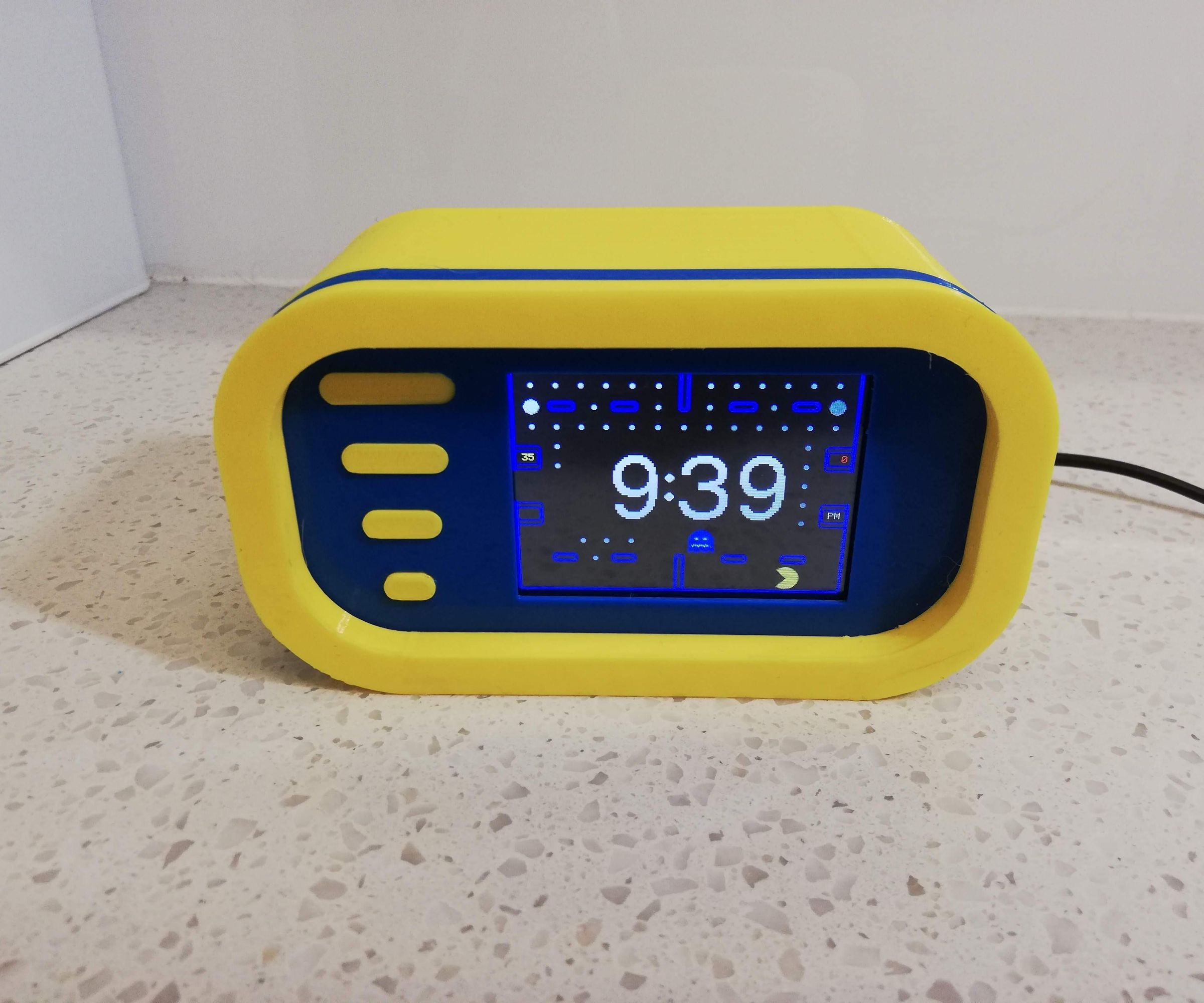

Place the Circuit on top of the front panel with the four hole guides which should align the screen centrally in the cutout. Power on the circuit so you can see the front panel screen, check the screen image is in the correct position then glue into place with Hot Glue. The outcome is a snug fit with a square screen which is centered in the cutout hole.
3. Final Assembly
Gently push the Front Panel onto the Back Panel and gently pulling the USB power cord to take up the slack in the back panel. The cord grip is useful here and should protect any damage to wiring. Plug into the USB charger and you're good to go.
